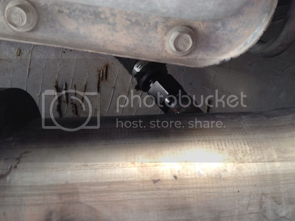

The nipple would get welded into the exhaust pipe just pass the tran's crossmember, how ever it can be used as a draft tube or routed to a catch can if you don't want to connect it to the exhaust.

Aren't you concerned about restriction by reducing from the factory 1" CCV hose down to 10 AN which is 5/8" hose for your system???
dieseljosh07
399
Georgia
No, your factory 1" hose is all of 4" long. Our #10 line is 6 feet long. This allows more than enough flow while maintaing velocity. And when our scavenger fitting is connected to the exhaust the scavenging affect of the exhaust flow will move the CCV even more. I believe a #16 hose would slow down flow.

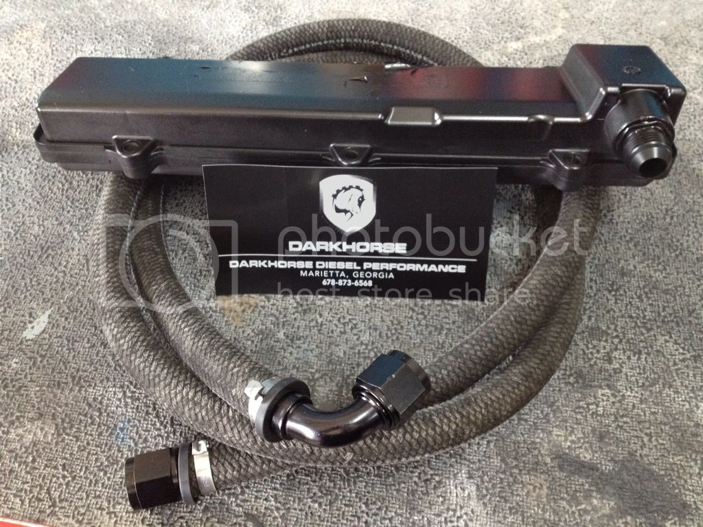

DH CCV 6.0
We have the 6.0 kits ready.Sorry it took so long but my supplier has been Slow shipping the parts I need to make them. These kits include, New OEM CCV, 4 new O-rings, hose and ends, ready to install with all hardware needed including the block off plug for your intake. Thanks
$295.00
4tonGT40
Oct 3, 2011
412
MArietta,Georgia
looks awesome. have one question though. what would be the best option for us with 03 and early 04 6.0's
Honestly Josh would be better to chime in on this, but im hoping that we can buy just the elbow out of the valve cover and modify it to suit your needs. I will work with Josh on this asap.
