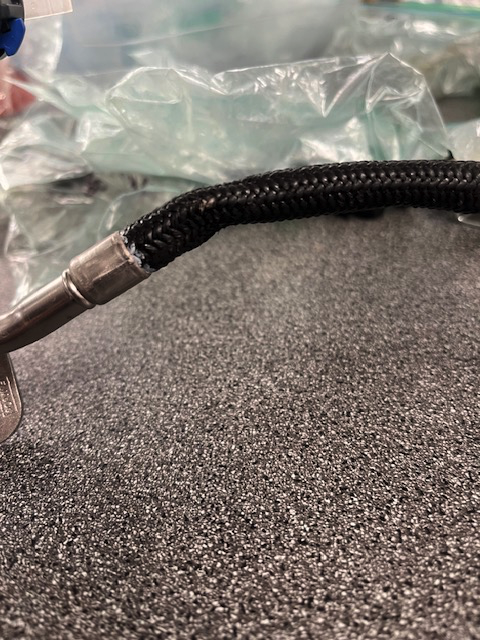

Today checked the main filter - tight all the way, but found the flex line (that goes to Driver's side rail Pressure regulator) to be kinked and twisted . That should be causing the restriction. Am I on the right path?
Depending on how kinked it was, it definitely could be. If it was kinked as much as a garden hose you’re cutting water flow from, yes, if it just has a little kink in it, it would probably be ok.

The picture is at its normal position ,when connected it becomes a lot worse -kinked and twisted sideways . It would be probably 80% restricted at least. I am ordering a new one ASAP and hopefully that is the culprit.

I had that noise during my cp4 adventure. The hose I was using with the pressure test port got pinched. For me it was a simple fix. But if that hose doesn't fix your problem I would try another fuel filter.

Truck is fixed ,thank the Lord!
Replaced the Low pressure rail where at the flex connection was a kink and the screeching noise stopped and no more blow off return line of injector#6.
But there was another problem - Rail pressure at 6511 psi and at KOEO it would still shows 2600psi which was impossible. Cracked an injector line and no pressure at all , not a single drop and FRP sensor still shows 2600 psi.
Turned out to be a defective FRP sensor which was BRAND NEW . Replaced it with another one and all pressures back to normal.
