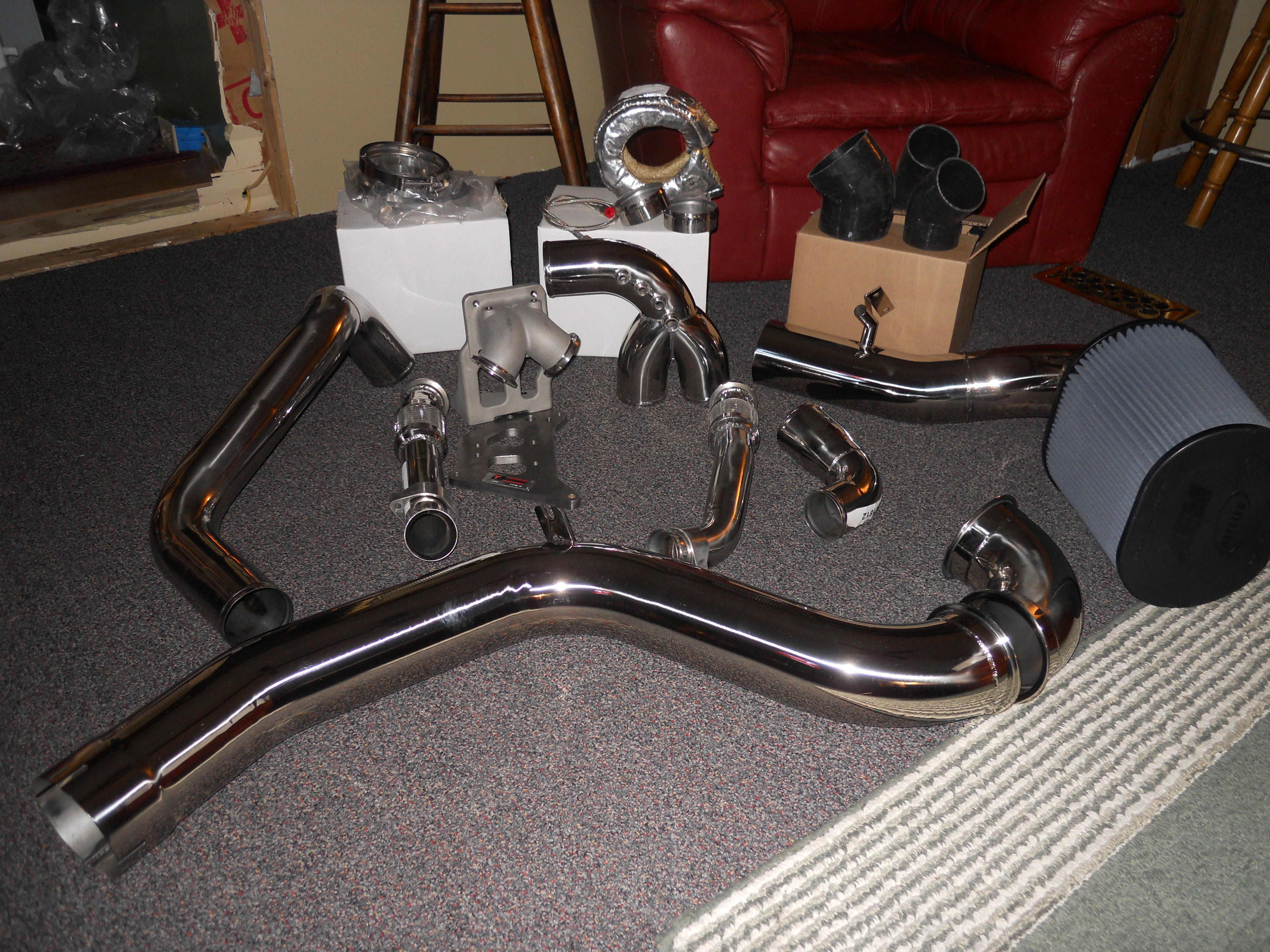

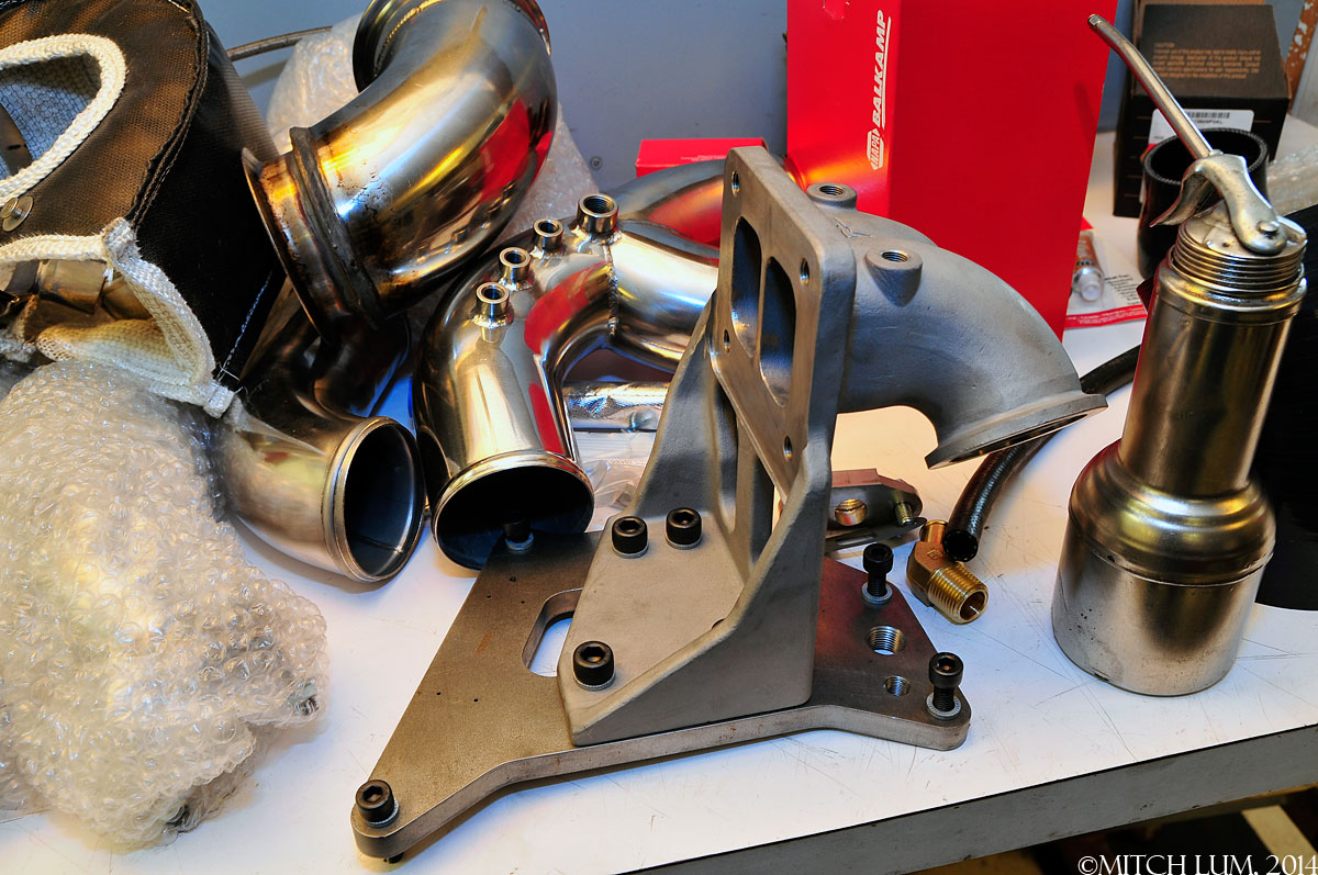

You can see some of the kit parts laid out on the bench in his clean room. Mounting plate, pedestal, Y-pipe, downpipe elbow, turbo blanket.

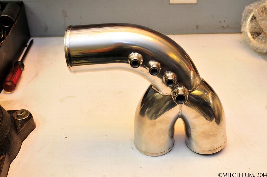

The Y-pipe is pretty cool and pre-plumbed for 3 nozzles – perfect because while doing the T4 kit, we were also installing a Snow Stage 3 MPG-MAX kit, with 3 nozzles.

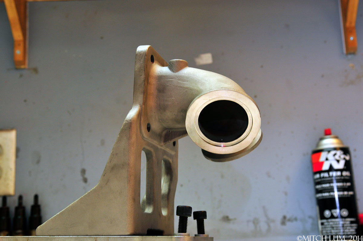

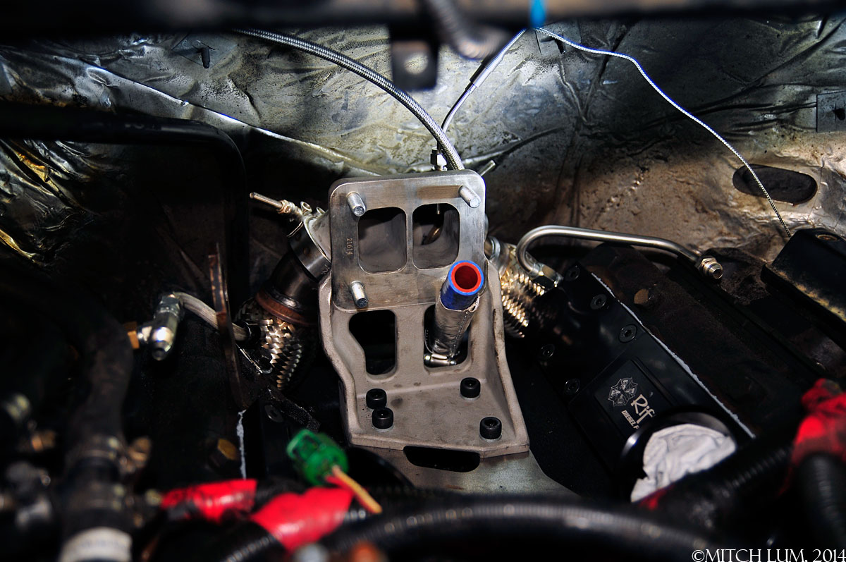

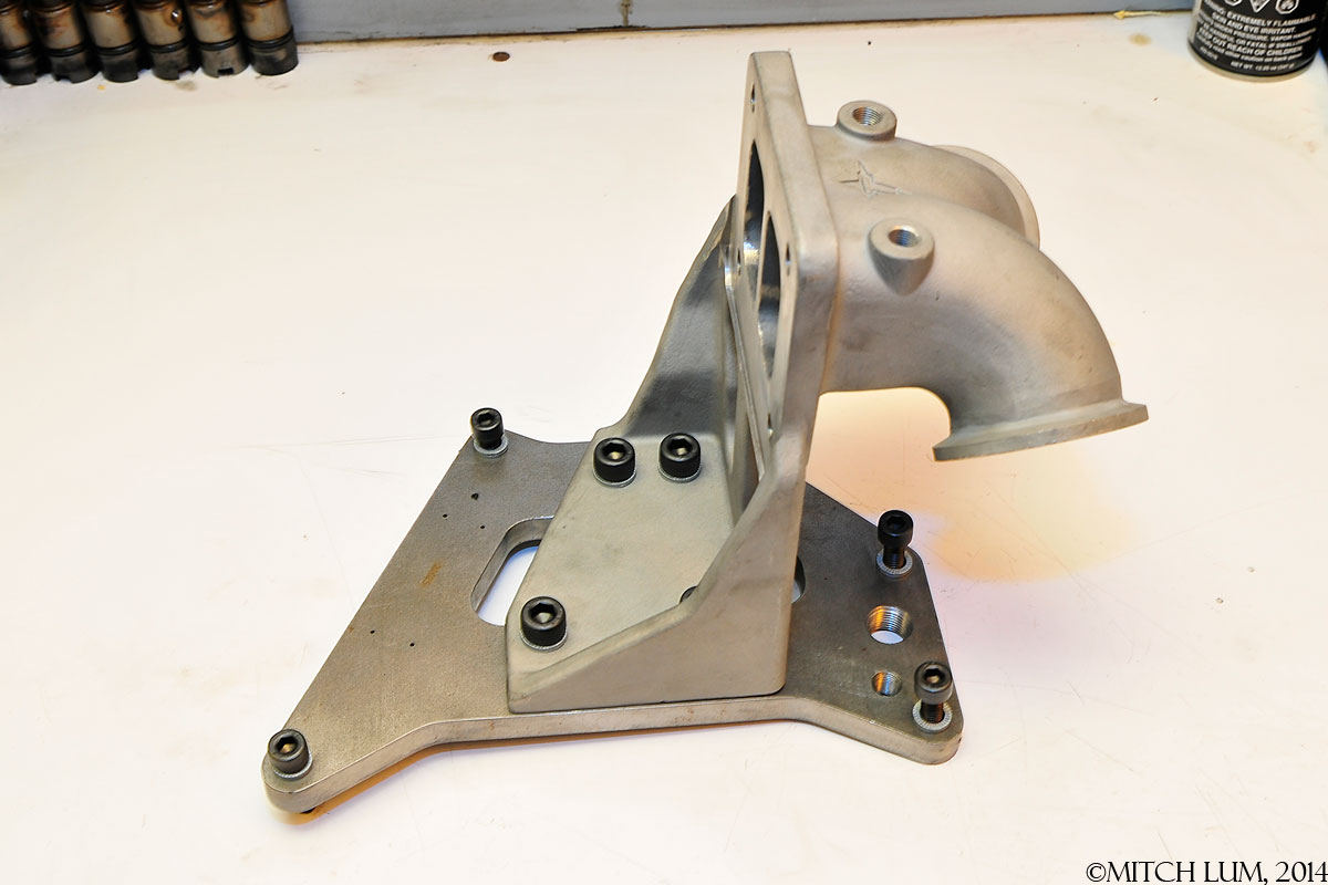

The mounting plate is designed so that the turbo oil feed and drain retain the factory location at the back of the valley, instead of dropping hot turbo oil in one of the forward/center ports in the valley (and onto the camshaft).
