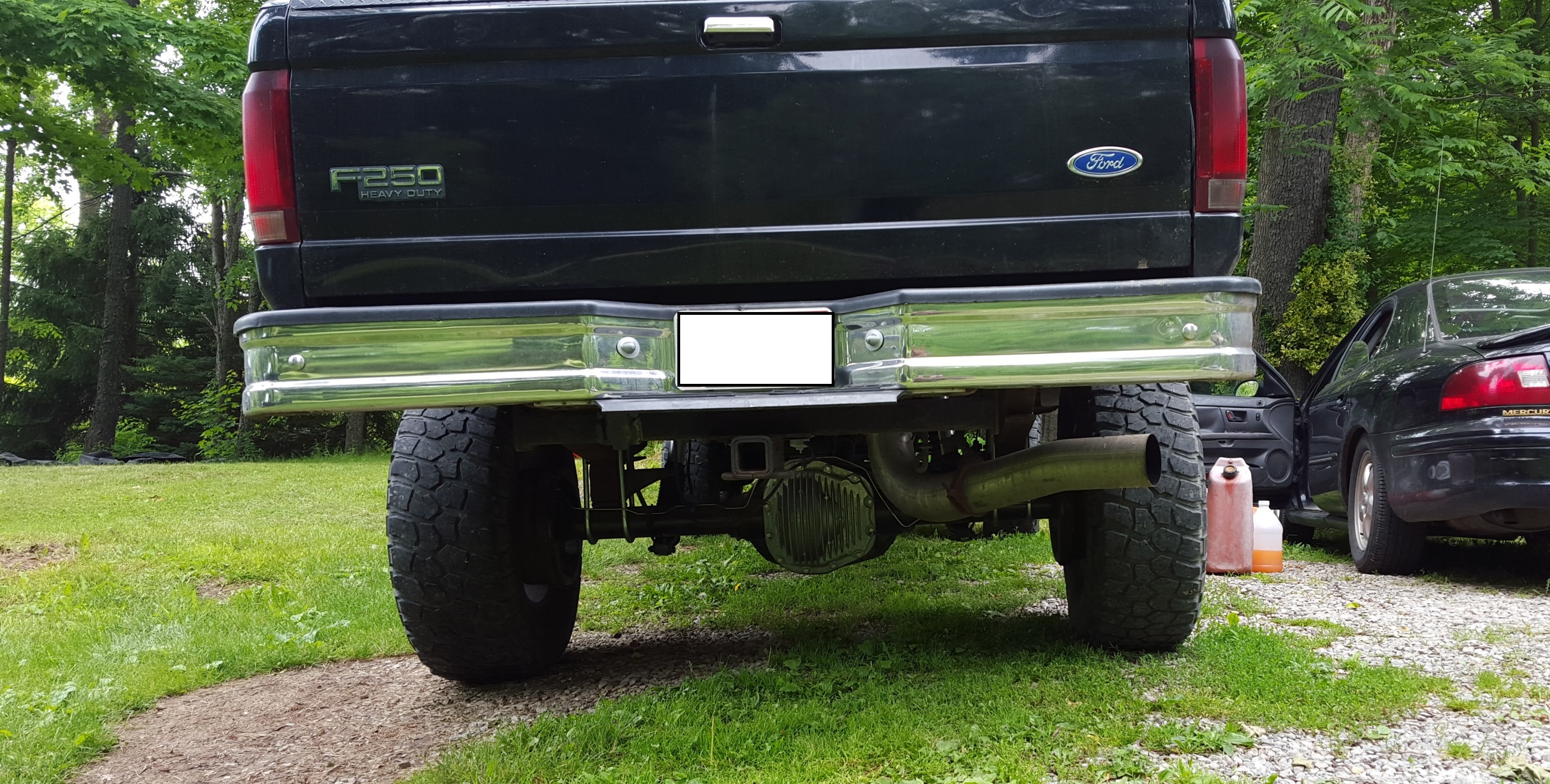

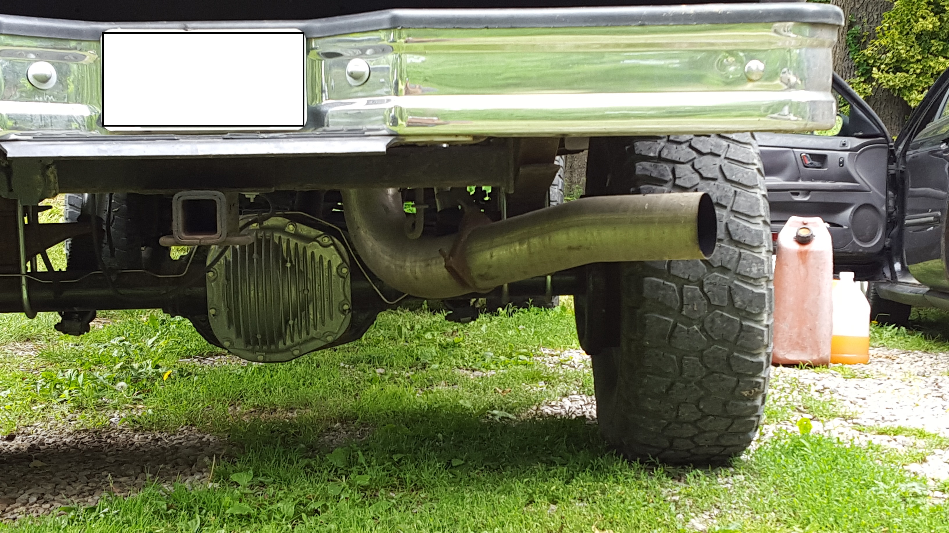

Guys, I have the Diamond Eye K5315A-RP exhaust. Bought it last year.
I have dicked with it a ton and cannot get the tailpipe to line up worth a damn.
Does anyone else have this kit, and can they share pics? I had tried to contact Diamond Eye a dozen times last year, left their application guy a few voicemails and never got any calls returned.
If I tip the tailpipe up so that it is horizontal where it exits, than there is a big dip right where it comes over the axle. If I twist it to get rid of that dip after the axle, than the tailpipe exit angles down stupidly. Not to mention, it seems my exhaust hangs pretty low, considering that it makes contact with my passenger shock and one of the heat shields between the frame and the bed.

Thanks!! Looks like yours has the same dip after it comes over the axle. At this point I may just cut the tailpipe section in a few places and reweld to get a better fit.
shmoozer
Jul 31, 2012
1,143
Could you cut a section out just after it goes over the axle? That would move the dip afterwards further up and should level the tip out.

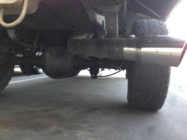

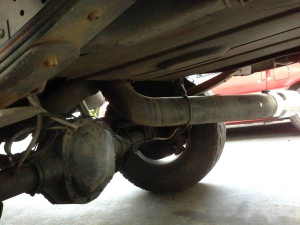

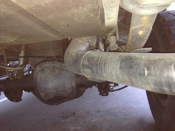

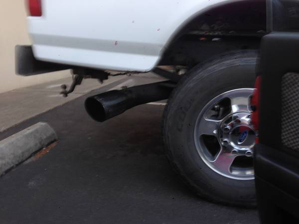

[/IMG][/IMG][/IMG]
Mine i know is diamond eye and 5" but must be a different kit. I'm remembering now that I believe i cut some off the end of the hump where the tailpipe attaches. Hopefully these help.
freddie
301
Ohio
Thank you for the pics! I am going to have to start cutting. Its driven me nuts long enough.
