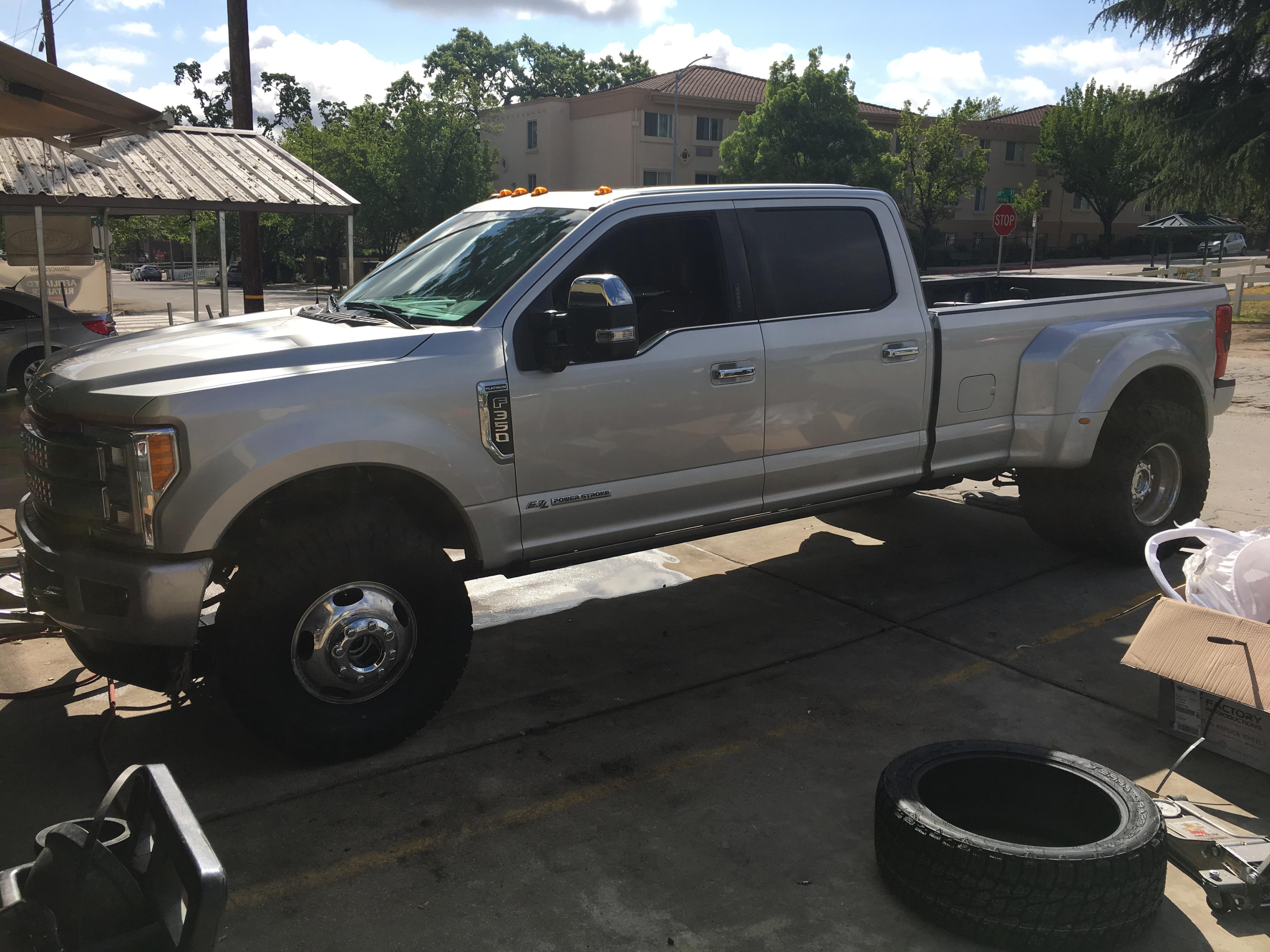

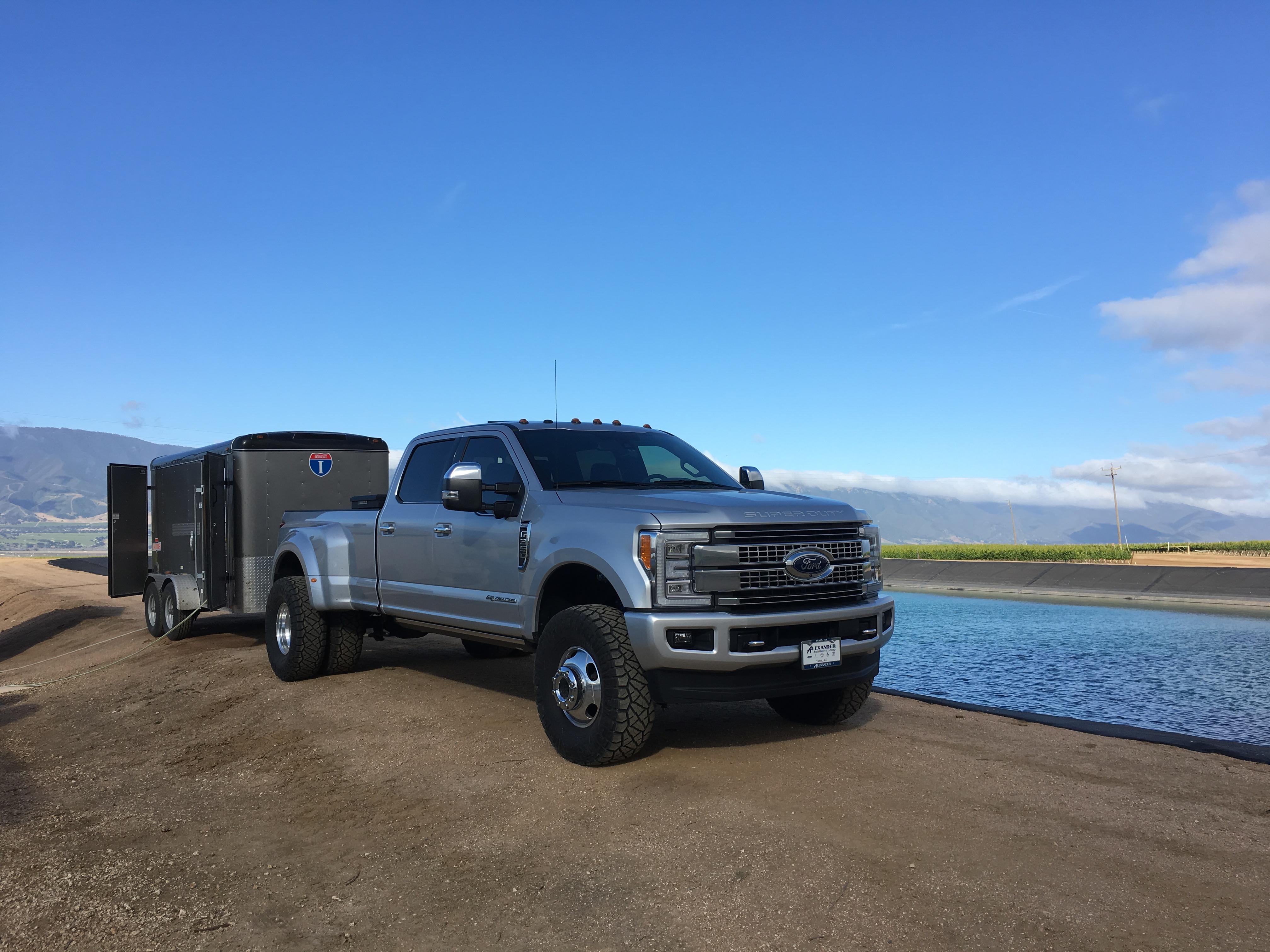

I ran 37s with no leveling kit. While I was waiting for my King Coilovers to show up. I was surprised but they fit fine with no rubbing.
Of coarse you will need 2" spacers in the rear to put the 37s on.
Attached is a picture of the truck with the Kings on it.

Attached is one with just the truck stock on 37s.
The other you can see the difference between stock and leveled on King Coilovers. I had not installed mine yet so its a good side by side.
