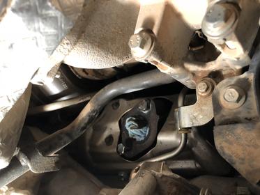

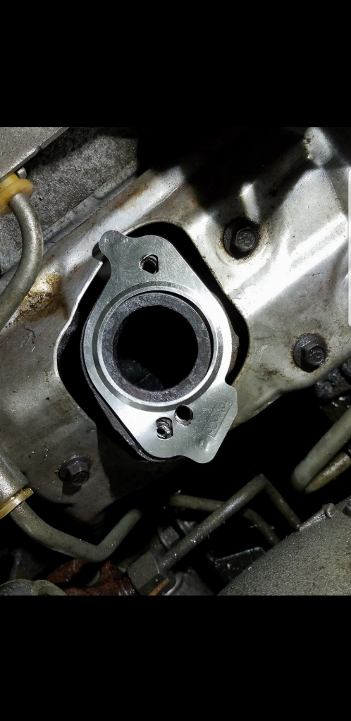

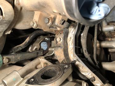

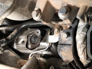

Just wanted to share/offer another alternative to drilling and tapping the two little bolts holding pipe from exhaust manifold to egr cooler. It’s well known these twist off. I’ve not had much luck in the past drilling out twisted off bolts. I guess I’m not patient enough or don’t have the right equipment to do it. I know many are quite efficient at I’m, I’m not. Welded 5/16” nuts to broken bolts and unscrewed them. Ground to the exact piece you are working on, in this case, the exhaust manifold. Used 7018, welded bolt and let it fill up the nut. Let it cool a bit, and started working it out. Each of these came out by only welding one nut to each. Sometimes it takes multiple attempts to get enough heat to get the job done.
