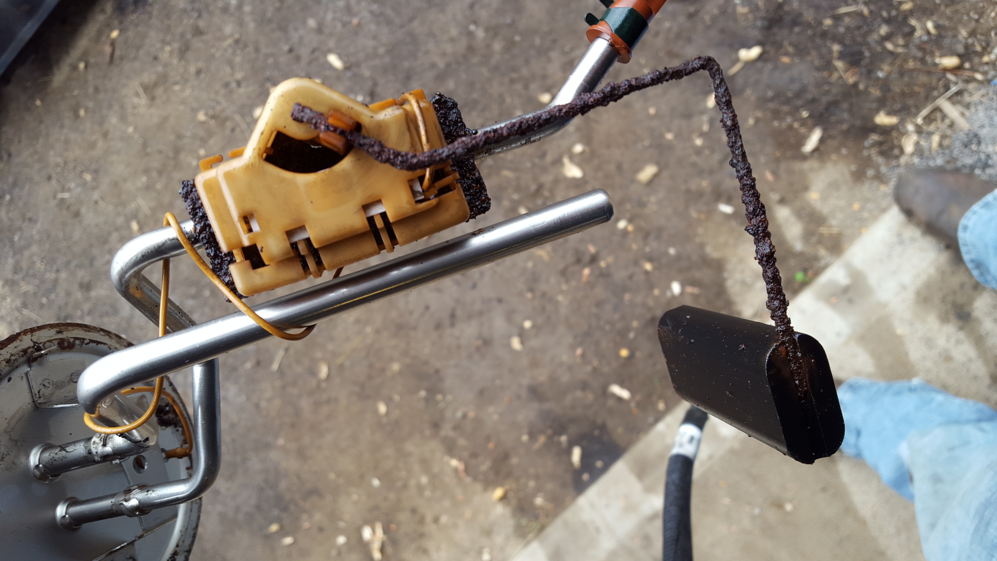

Putting new front and rear tanks in, as well as troubleshooting fuel gauge problems. Pulled my sending units out..
When switched on the front tank, the gauge would instantly go to max full.
On the rear tank, the gauge would go empty. I assumed a cracked fuel float. I have yet to test the sending units with a multimeter but should have that done tonight.

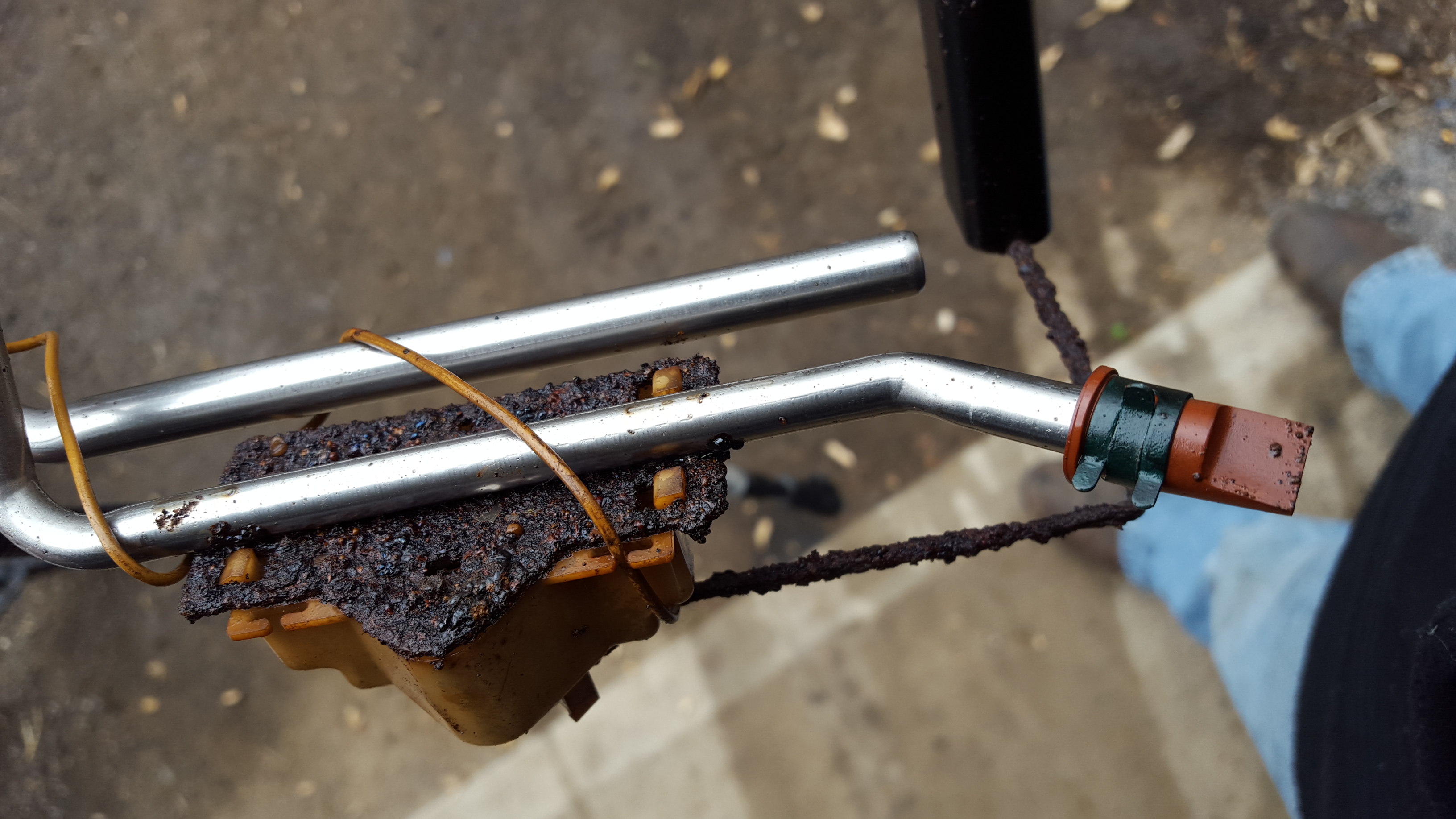

The front float system needs replaced just due to the amount of rust. I see the Motorcraft PS19 as a possible option. Has anyone used this?

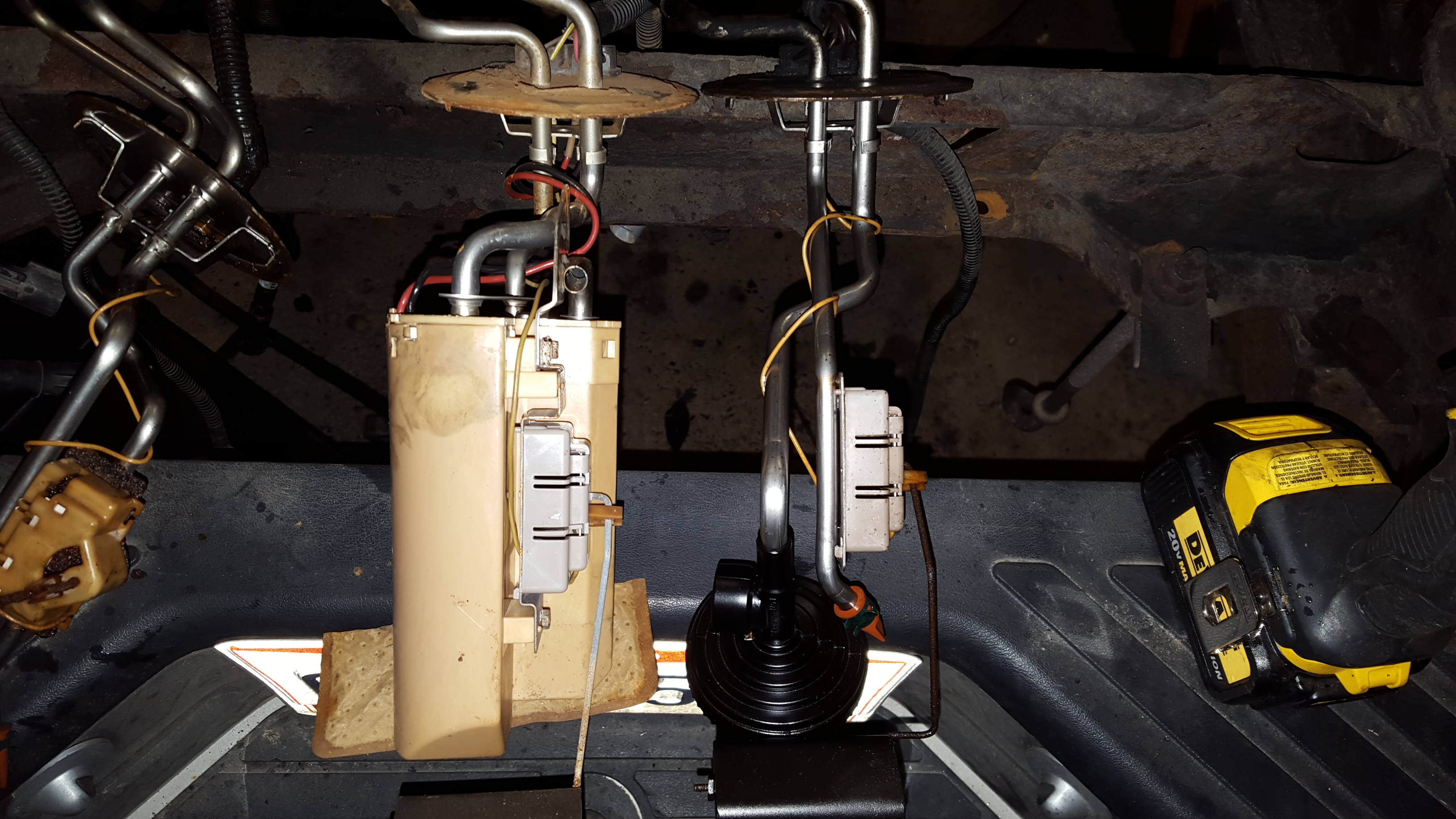

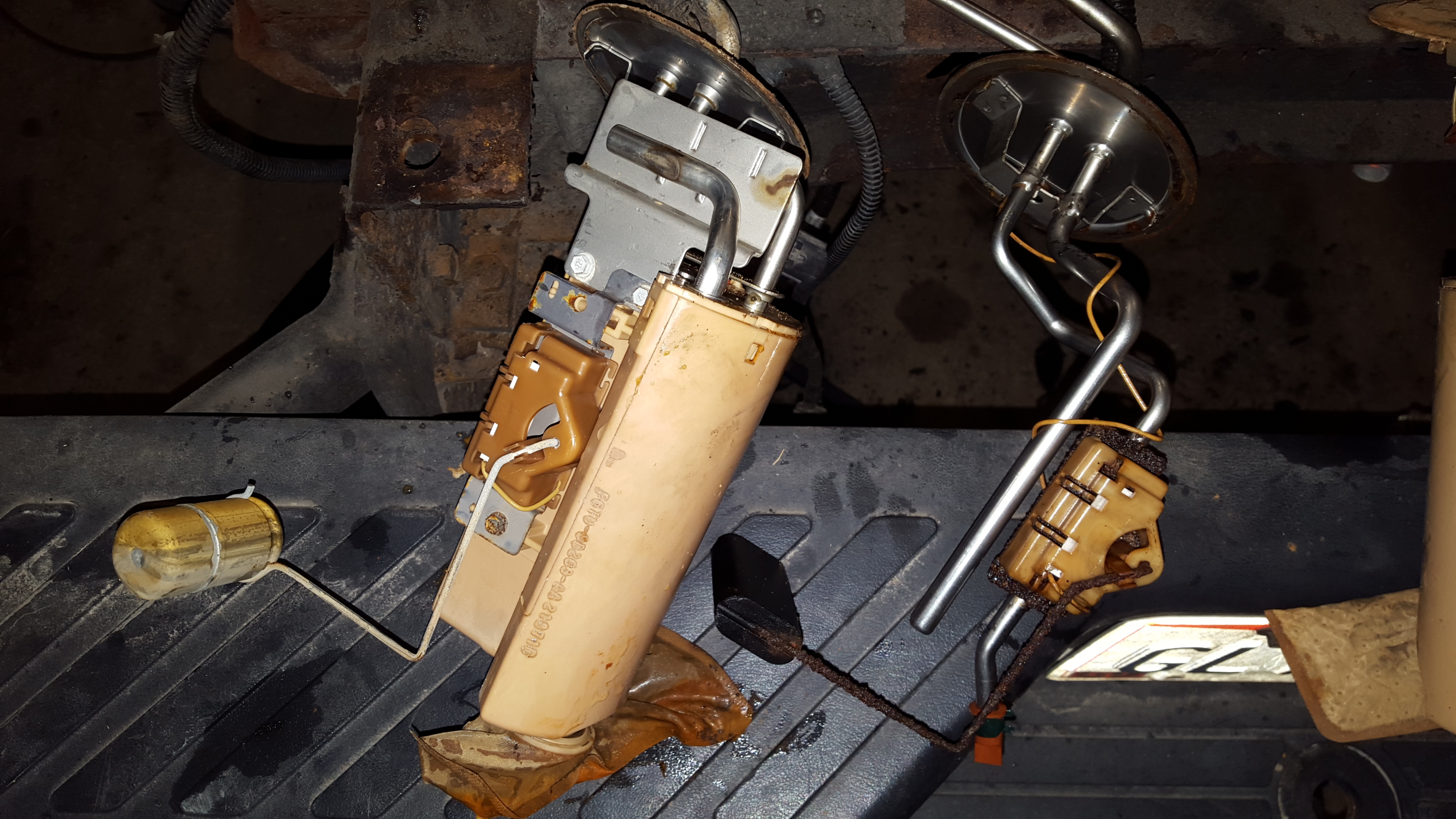

I pulled the sending units from my Dana 60 donor truck (gas). I'm wondering if I could strip and adapt the gas sending units to work in my truck...? Or just use the gas rheostat on my diesel sending unit.
Has anyone ever done any of this? I see there are also companies that rebuild the sending units but I have not got pricing.
