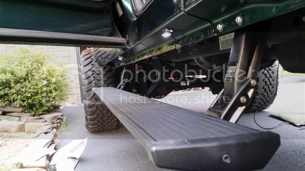

Got a set of AMP steps off josh for my dad's truck and got them installed tonight. They turned out killer. Install took me right around 3 hours, and overall was a very easy process. These are a def must have!!
This is installed and tucked away
Flipped out
The lights are perfect sized and work awesome at night
This truck has 6" of lift and 37" tires and the steps are plenty low even with that size of a truck
Close up of the lights
Oh look there's my truck creepin in on the action too lol
