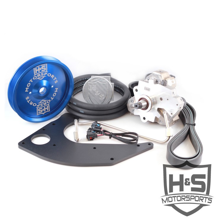

Not to hijack your thread but I am doing a similar build on my 6.7, 364.5sxe and dual fuelers. Does the low pressure fuel system need to be upgraded?
