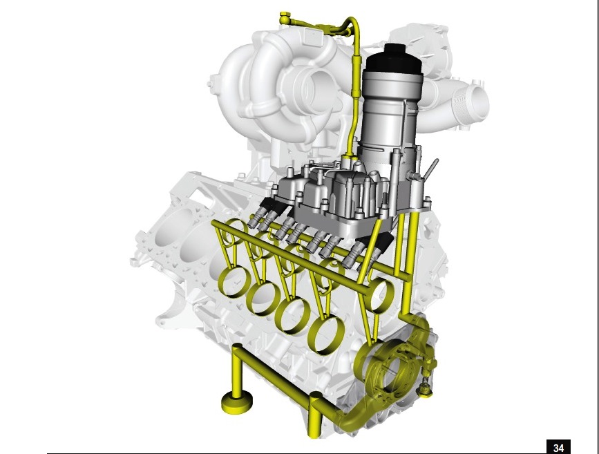

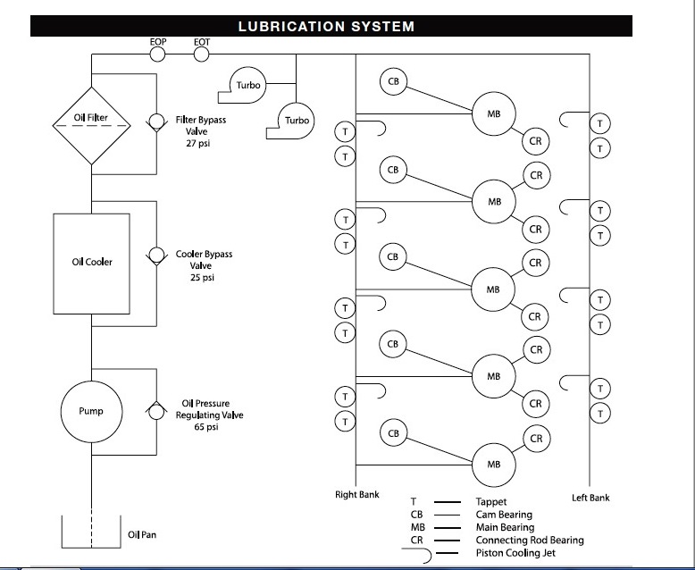

from the coffee table manual:

Amsoil filters down to 2 microns. The supply comes from tapping into the oil filter canister top and runs to filter and then runs back into the oil fill.
Ok. Is this the kit that eliminates the oil filter at the engine and relocates it or just simply robs oil from the unfiltered side of the EOF and moves it to the 2micron system.
If the latter... then it is simply bypassing too much oil and putting it back to the pan.
CATDiezel
Dec 27, 2011
2,221
Well I wrote that last response before looking at the schematic provided above.
Interesting problem. I'm not familiar with the bypass kit on the 6.4. But regardless its the same theory as every other engine.
