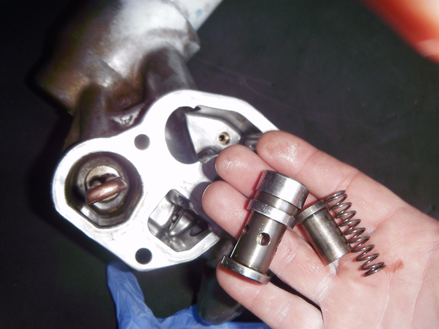

JMHO: Use Ford/Motorcraft O-Rings and gaskets only. Don't use aftermarket parts. Too many horror stories of them not sealing. Also, since you have a 95 it probably still has the oil cooler/filter header adapter where the filter bypass valve (spring/washer/disk under where the filter screws on) and the oil pressure regulator valve (on the block side of the adapter) are simple "staked" in. The valve parts can fall out, and in the case of the regulator, may not be noticed. This will usually can a no start due to low oil pressure feeding the HPOP reservoir. Cheers!

Yes. The regulator parts are on the backside of the filter housing. The bypass valve can be viewed when the oil filter is removed. The early trucks as can have these parts just fall out. They updated the housing later to hold the parts in with snap-rings. On my 94, I had the bypass valve parts fall out and noticed them when I changed the oil and found some of the parts in the oil pan. I ended up getting the updated adapter at $139 (they are stupidly expensive now). I mentioned the regulator valve as many folks don't realize that they are there and lose those parts if they fall out unnoticed. Cheers!
