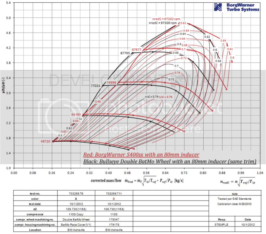

Why I don't use batmowheels lol. Well here's my answer. My friend sent me an email today. The is finally a chart for a dual batmo charger. Came out to what would equal about 80hp less than a std Borg Warner charger.
"All the info you'll ever need. The 80mm billet Double Batmo vs Borg Warner S400 80mm regular wheel. Seth at Borg Warner had a compressor map made for it. Batmo exposed........
Batmo - .86Kg/s = 114lbs/min
Borg 80- .92Kg/s = 122lbs/min."
