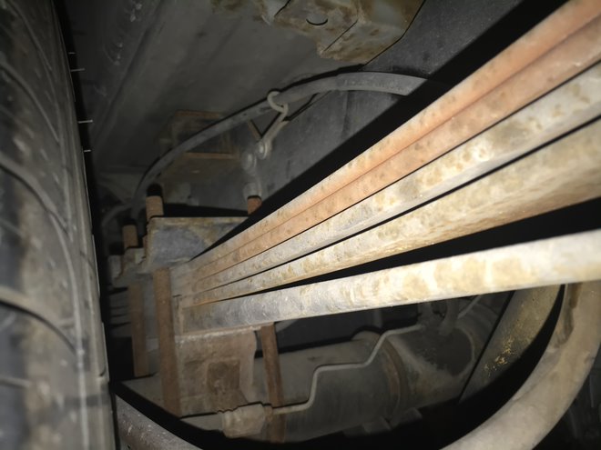

Does anyone have a pic of what factory 2002 leaf springs should look like? Trying to tell if these are factory springs with blocks are if the springs are part of it as well. Thinking about just removing the lift blocks and just keeping the springs (new U bolts of course)

Here's a quick pic of my 2002 spring. My truck is lowered and we took the overload off but I just ran out to the garage and snapped it quick. Does it show what you're after?

I think we are the same since you removed the overloads. Here is a pic of mine, you can see the factory perch on the axle tube, the the factory load stop, then a lift block, then it looks like an extra or factory overload block and spring. Of course now I am realizing the arch of the springs could be different as well to make the lift.
Ford005
Nov 16, 2012
The larger block is the ‘lift kit’. The smaller block and upper overload springs are original. The leafs springs also look original...definitely not lift springs.

Great! That is exactly what I was hoping for! I now know I can get new u bolts, remove the "lift blocks" only and be back to stock height Now I need to figure out the front end. Will post a pic on that in a min so maybe you all can help me there as well. I have a feeling its factory as well with extra pieces of metal sort of like a leveling kit. Will prob have to remove couple at a time till it matches the rear so it will still work like a leveling kit when done.
