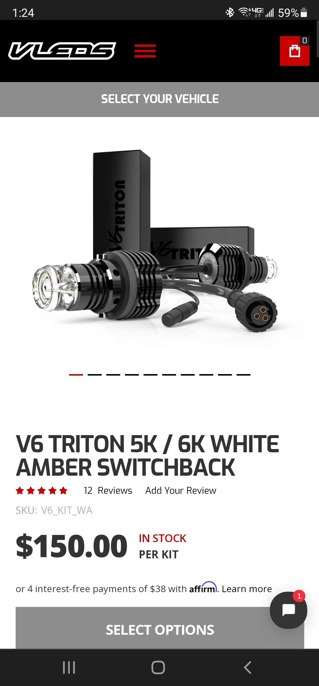

These?

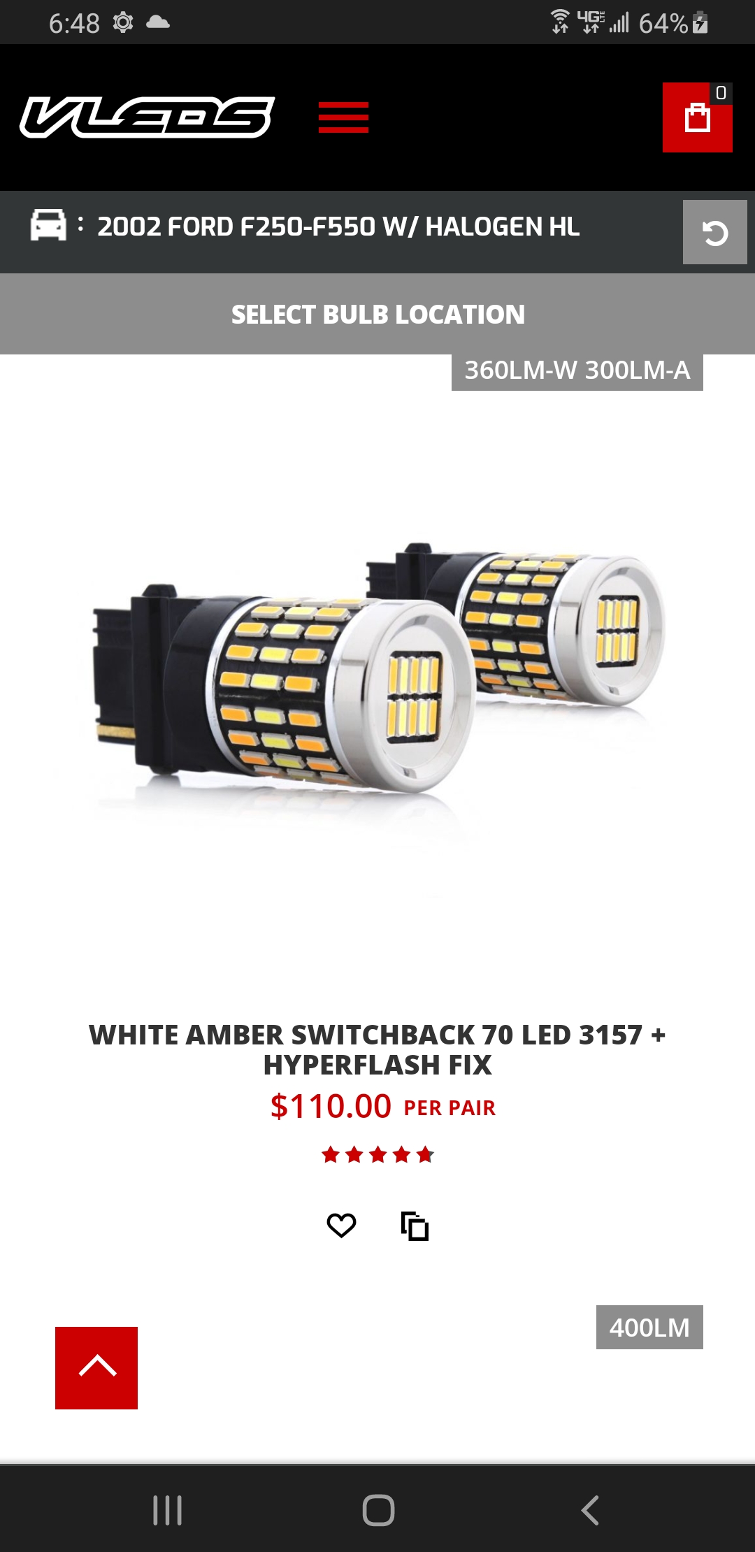

$97 for turn signal bulbs but that's OK. It's only money

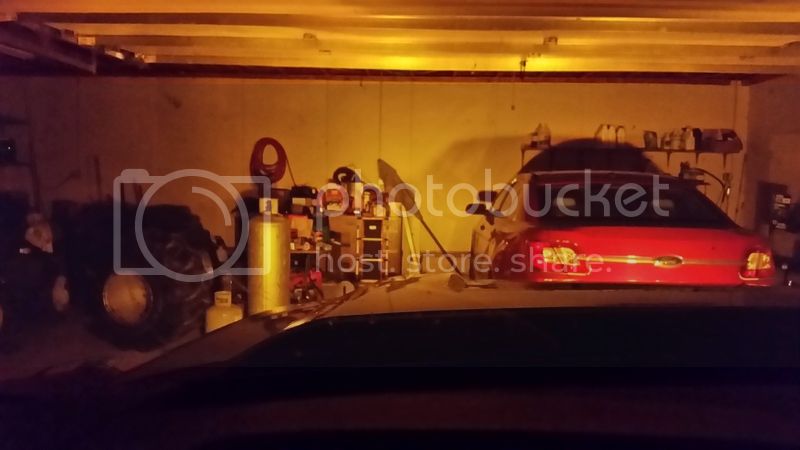

So driver side in video is led.
Passenger side is regular filament bulb.
There was no change when resistor went in besides corrected blink.

Flipped bulb yes. Even looked at it out of the light unit and there is no separate running vs turn. Running the leds dim and when blink comes in it get brighter.
Well see with bulbs

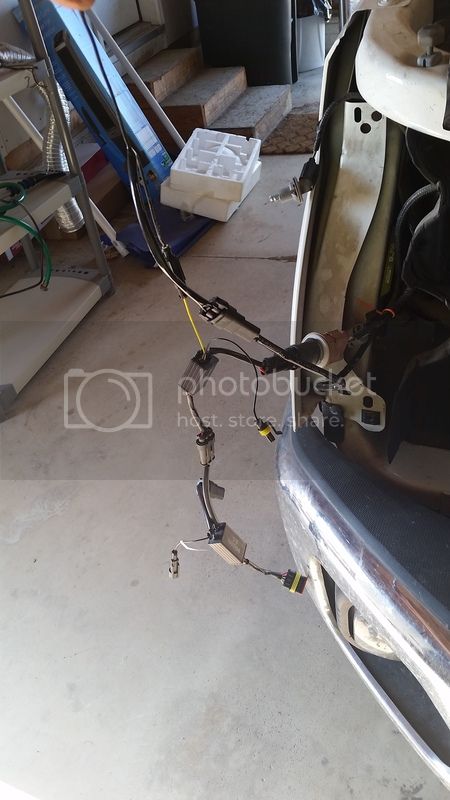

This is the rat's nest of wiring that went along with them. I believe the newer version moves the controller into the bulb to clean it up a bit, but it still uses the junk ass adapter plug that gets plugged into the factory bulb socket. I had a couple of those go bad and need replaced.

Same thing in the taillights. Had a controller go bad this year (year 5). Pulled them and replaced with Profile LED. For some reason, the Profile will work in the taillights, but not the front on my truck.
The VLeds use a weatherpak type plug on everything, except the build adapter to the bulb socket. There's a provision to plug in their resistors. It's a nice system, I just got tired of messing with it. Seemed something minor would go out at the least opportune times.
