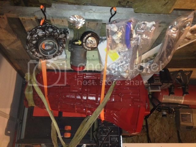

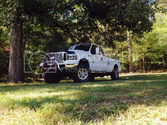

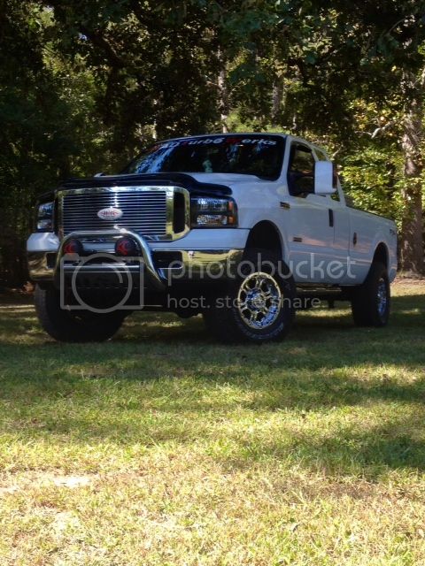

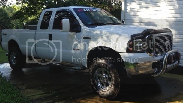

Ok, so its about time to get Mighty Whitey back in the power game. The end goal is a reliable 550+ RWHP capable of everything from daily driving in town with the wife and kids, towing heavy (14k+), hitting the track/dyno at events to cruising down the highway with the family and boat in tow and the wife driving. I want an all around good, reliable, useful truck thats capable of making respectable power and still doing everything it could from the factory, just better.
She began life as a 2006 extended cab, long bed, 4x4 w/ FX4 package. I've Added 17" Gear Alloy 715c Recoil wrapped in BridgeStone Dueler AT's (35's), a 2.5" front leveling kit and a replaced the stock 2" rear block with a SuperLift 3" block along with Ranch RS 5000 shocks all around and a Rancho RS 9000 steering stabilizer. She has 60,xxx miles on her right now.
Here's what she's got now-
ARP head studs w/ OEM gaskets
MTW stage 1
MBRP 3.5" DP into a 4" straight pipe
S&B intake
River City Diesel EGR delete
Quick Tricks 58V FICM
PHP Atlas 40 FICM tune
SCT Livewire w/ tunes from damn near every tuner out there
AIS boost activated, dual nozzle water/meth kit w/ 6 gallon tank mounted in the toolbox
GoGo diesel direct clutch solenoid
ELC coolant
DieselSite coolant filtration kit
Metal cold side CAC tube
HPS CAC boots and SS clamps
Strokers Unlimited Y-pipe w/ upgraded bellows, ceramic coated along with the River City delete pipe
Blue spring upgrade
EDGE CTS w/ EGT probe
GlowShift Fuel pressure (0-100psi) and Boost (0-60) gauges
Innovative Diesel upgraded HFCM drain plug
Quick Tricks Billet Oil and Fuel filter caps (polished)
Polished oil filler cap
Powder coated and hydro graphiced CAC tubes
Harley headlights
I'm sure Im forgetting something. I'll update this list if I think of anything else.
What she's gonna get-
Bullet Proof Diesel oil cooler relocation kit
Twisted Diesel Stage 2 trans with billet shafts, triple disc billet converter and upgraded solenoid pack
Regulated return (brand to be determined)
Beans Diesel Performance sump
Air Dog 150 feeding the HFCM or a new high pressure pump
Warren Diesel Injectors- Probably 175/30's but maybe upgrading to 190/30-50's
Ported intake manifold
Pusher intake elbow w/ 4 ports
Turbo will be by MTW. Maybe the MTW PMax and we'll undoubtedly try other MTW turbo's with this combination
What she might get-
4.10 ring and pinion set front and rear
Detroit Trutrac in the rear
Nitrous
If anyone can think of anything I've missed, let me know. I've added some pictures of the now for comparison to later. Hopefully I'll have plenty of pictures throughout the build. I'll keep this thread updated with the progress. It won't happen over night, but should be interesting to see it all come together. Thanks guys and bring on the comments, criticism or support.
