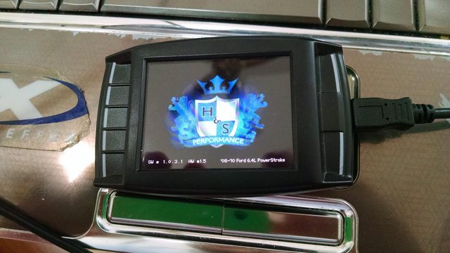

well i'm still having issues. it worked for a little bit now its back to getting locked on the boot screen... i'm going to check all my wiring and such tomorrow as one of my buddies works for a shop that things its a power issue.. however im also going to get a new sd card and format it. i'm really annoyed with this right now.

if you power it up from the USB port on the side, does it boot up properly or freeze? I fear that it's still going to freeze :( They'll boot up just fine in 6.4 mode even with no communication through the HDMI
drunk on diesel
Sep 7, 2011
4,179
correct...
they include that because some applications (6.7 Ford for example) won't come off the initializing screen if they're powered by the HDMI but have no communication with the PCM.
But, when powered from the USB port, they will come off the initializing screen and allow access to all menus, etc.
The problem is (and the reason I don't want you to get excited at all) that when it's in 6.4 mode, the mini will boot straight to the main screen and will go back to the main menu. You can even export 6.4 files to the SD card with the head unit being a thousand miles away from the truck!
That's why I say I think it's the head unit :(

hey sorry man, long week and i finally was able to pull the mini maxx out of the truck and bring it inside and take a look at it. plugged it into my computer and it wont boot. :( for reference i did take a picture of the screen it gets stuck on.. not totally sure where to go from here. one of my buddies who works at a diesel shop was telling me it could be a power issue, however everything else i plug into my OBD II port works. plus all my other accesories work and i cant seem to see any fuses out anywhere.. so i'm leaning to the head unit being bad.. however i just cant fathom these things going bad. it makes me sick to think about.. the only thing i havent done yet is get a new SD card and reformat it. so i'm going to order one on amazon and try that.. truck is currently stuck in the tow tune as it was working after hardwire and i bumped my tune up from stock. soooo thats where we sit right now with this.

hate to bump this thread up, because that means i'm still having issues. i guess my question is, anyone know if i have any option other then buying a completely new headunit? which i know won't be cheap
