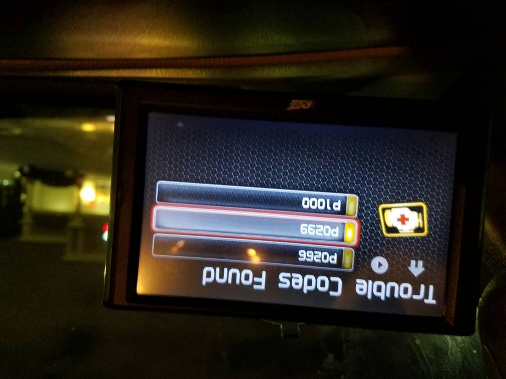

So my 6.0 runs fine when I start her up. She idles great and my Edge Insight says all is well with the FICM and ICP. But when I get up to operating Temps like 220 while driving it will dive into limp mode.
I got a cylinder 2 contribution code and low boost code. Figured it was the CAC tubing and replaced that. Cleared the codes and she ran great again til operating Temps then did it again.
This time got cylinder 7 and cylinder 5 and 6 contribution codes. I changed the blue spring kit into the FPR and ran great til I got her up to operating temp.
Could this be my EGR or am I really losing that man injectors. I just bought the truck from Ford and they did all the the matinanace on it they say.
Any help would be appreciated.
