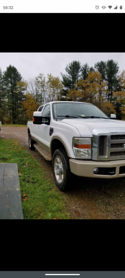

Need some 6.4 guys advice, I'm looking to buy a 08 f250 ccsb KR 4x4. It's southern and totally rust free 190k on body. 5k on fresh engine.
Engine build includes.
Kdd overhaul kit with maxx7 coated pistons.
Colt cams stage 2
Kdd o-ring heads.
Mishimoto oil cooler.
Snb intake.
High flow exhaust
Rudy's heavy s.s. up pipes.
EGR coolers fell off.
New oem rockers, hpfp, hfcm,injectors,
Sct livewire ts with only a 50hp tow tune
New radiator .
Snb poly body mounts.
All parts above put in at 190k. 23k price.
Is this a good buy ? that will be reliable if left alone?
I would use it as my daily and towing 9000lb camper during summer months.
Thanks

If the egr cooler fell off the same time as the dpf pipe. Then that parts good to go.
The only thing I would want to change is the torque converter. Other than that I would say it should be very reliable. As long as the tune is good.
For what is done to the engine, I would say it's a good price. The miles on the pickup would not bother me one bit. I would still look at changing the TC.
Who wrote the tune?

The seller claims the little power shop. Thanks for the heads up on the converter. Also the seller said he had the thermostats left out. That shouldn't be a big deal right?

I asked why they were left out, according to the seller he had mishimoto ones and heard they fail quickly, left them out so he could drive it and put motorcrafts in. He said the heat still works fine so he hasn't worried about it. I told him I'll need motorcraft units put in before I'll buy it.
