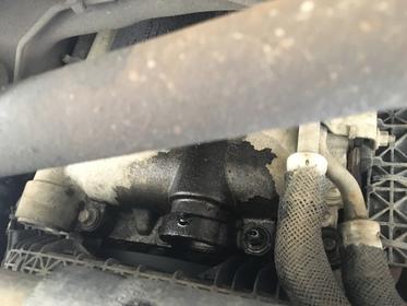

Went to put the new exhaust on last night and found this. Any ideas?
Mar 20, 2016 #1 H Horsemover New member Joined Feb 13, 2016 Messages 132 Reaction score 0 Went to put the new exhaust on last night and found this. Any ideas? Attachments image.jpg 17.1 KB · Views: 116

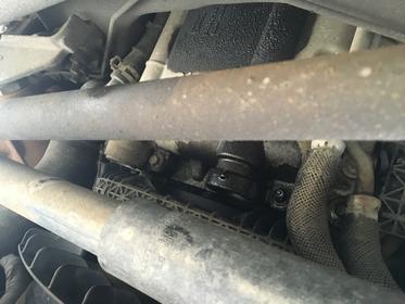

Mar 20, 2016 #2 H Horsemover New member Joined Feb 13, 2016 Messages 132 Reaction score 0 Here's another pic Attachments image.jpg 16.1 KB · Views: 110
Mar 20, 2016 #3 6.0 Tech Well-known member Joined Sep 9, 2015 Messages 3,485 Reaction score 101 Location Mesa, AZ Check vacuum pump gasket, seen a bunch of those leak.
Mar 20, 2016 #4 H Horsemover New member Joined Feb 13, 2016 Messages 132 Reaction score 0 6.0 Tech said: Check vacuum pump gasket, seen a bunch of those leak. Click to expand... Thanks...strange thing is I don't have any on the driveway. It looks like it's been all blown back when running down the road.

Mar 20, 2016 #5 6.0 Tech Well-known member Joined Sep 9, 2015 Messages 3,485 Reaction score 101 Location Mesa, AZ It could be a small enough leak right now that its somewhat burning itself going down the front cover so that it doesnt drip.

Mar 23, 2016 #6 H Horsemover New member Joined Feb 13, 2016 Messages 132 Reaction score 0 6.0 Tech said: Check vacuum pump gasket, seen a bunch of those leak. Click to expand... You sir were correct...Thanks appreciate you pointing me in the right direction.
