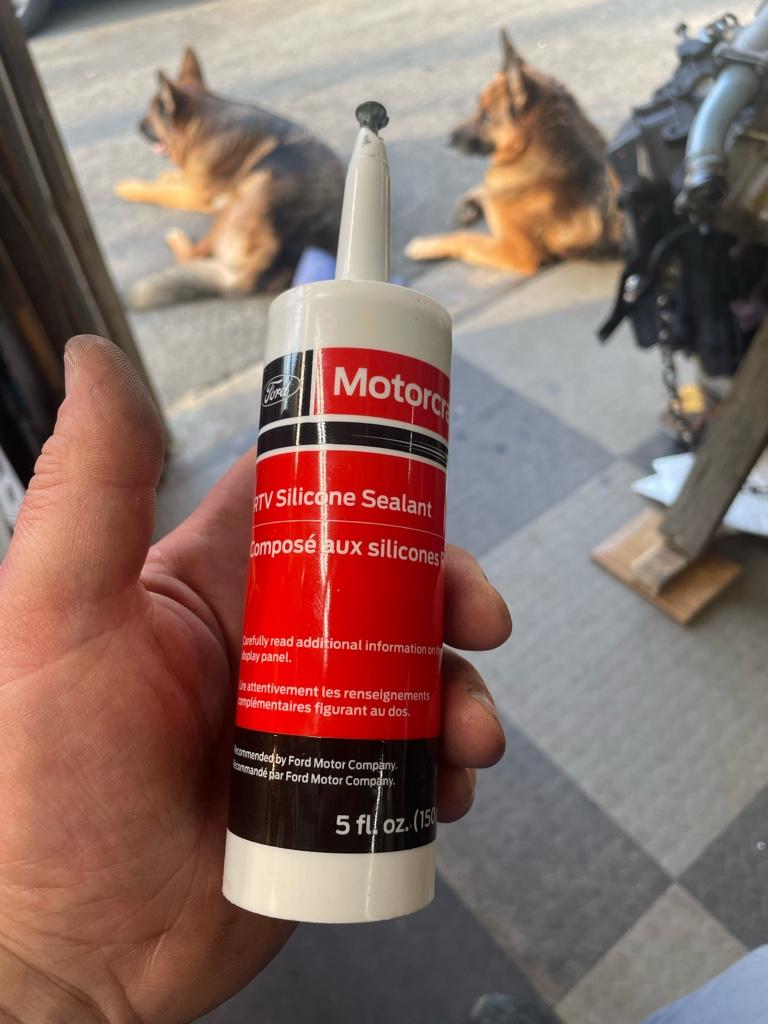

Got my New Ford oil pan and 1-tube of Ford silicone sealant...
Any tips before I lay down the silicone bead and tighten the bolts?
I know ford has specs on how thick of a bead to run on the side/ends... but I can't seem to find it.
I know, it's pretty much common sense ... I've replaced oil pans in the past...
I guess I'm a little apprehensive since it's such a task to get the engine out.
thanks.

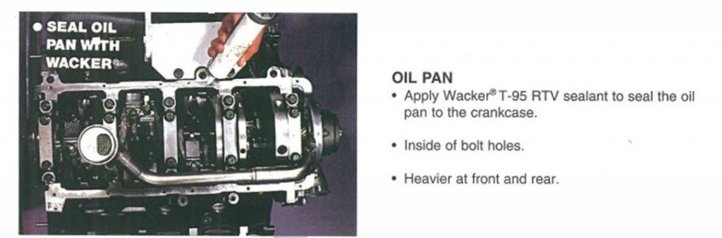

I didn't see a spec, but these are from the old "7.3L PSD Coffee Table Books". Cheers!

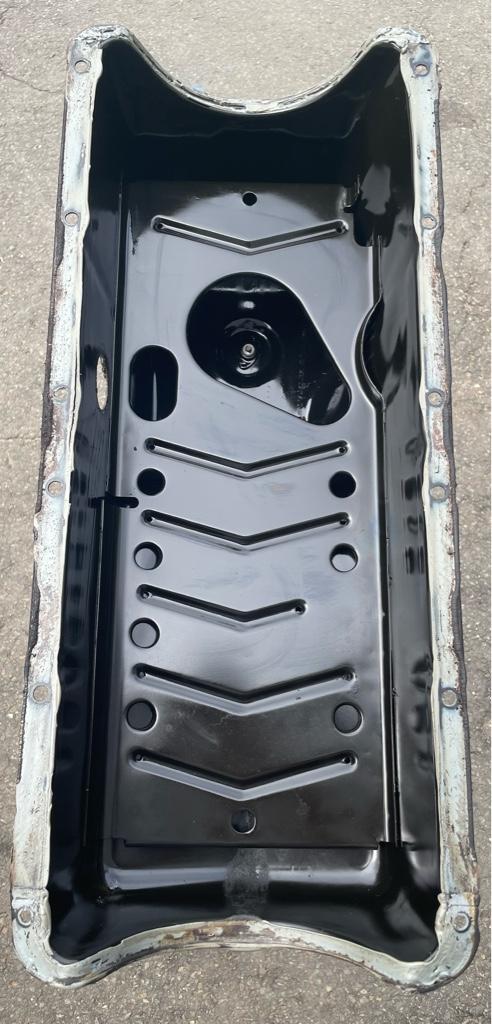

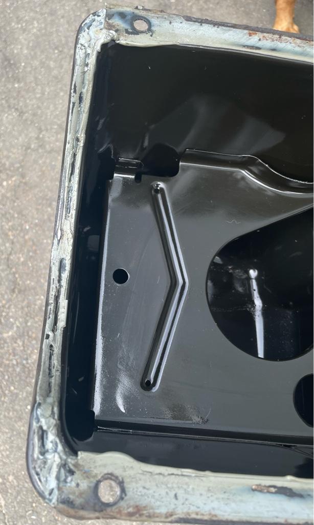

It was interesting to see the amount of silicone from the factory.
NOT An excessive amount
Although there was some silicone squeezed out both inside and outside of the oil pan.
Nothing that squeezed inside the oil pan ever left.
So I assume Ford uses that method also…..
letting the silicone cure properly.
You can also see the extra on the inner corners.
I never had a problem with the oil pan leaking, it was that poorly designed dipstick tube adapter that started leaking.
I nursed it for several years with JB Weld and everything else.
But when the exhaust manifolds went I decided to pull the engine and also do a little bodywork.
Along with this stock pan I have decided to use the strictly diesel dipstick tube adapter.
It’s a little pricey but if the O-ring(s) ever fail..
They are easily replaced since they are on the outside not the inside.

Both of those will be good to go. The TA-31 was designed for the 7.3. Its designed to not cause the oil to foam. That's all I will use on a 7.3. I even use it for other engines as well. I like the stuff.
