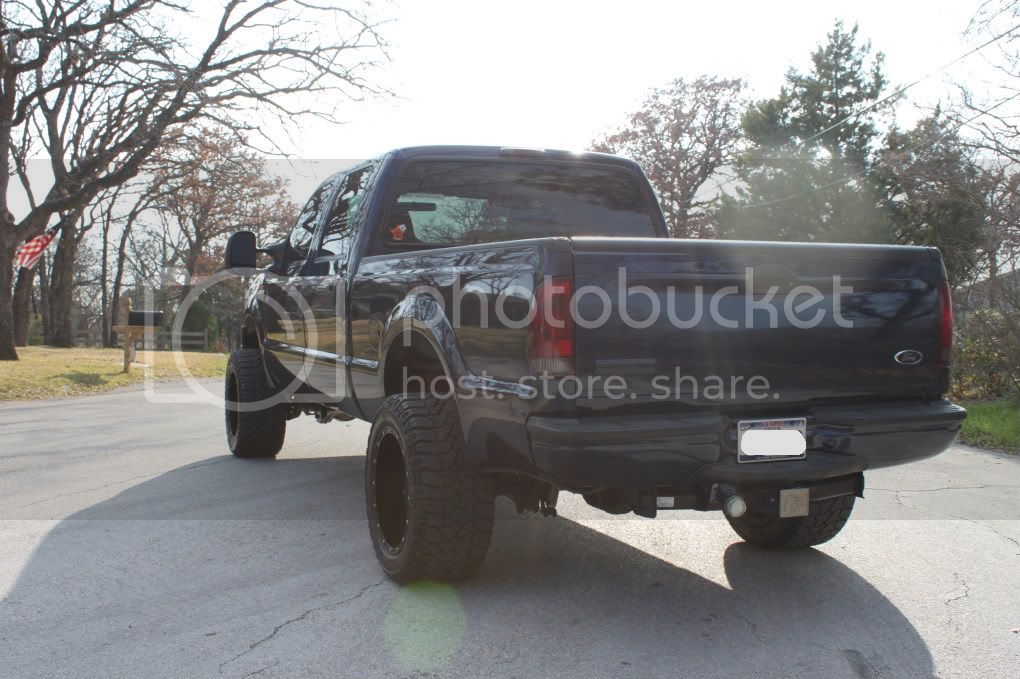

Did mine last weekend. Turned out great! Here is a pic
imelmo
6,631
