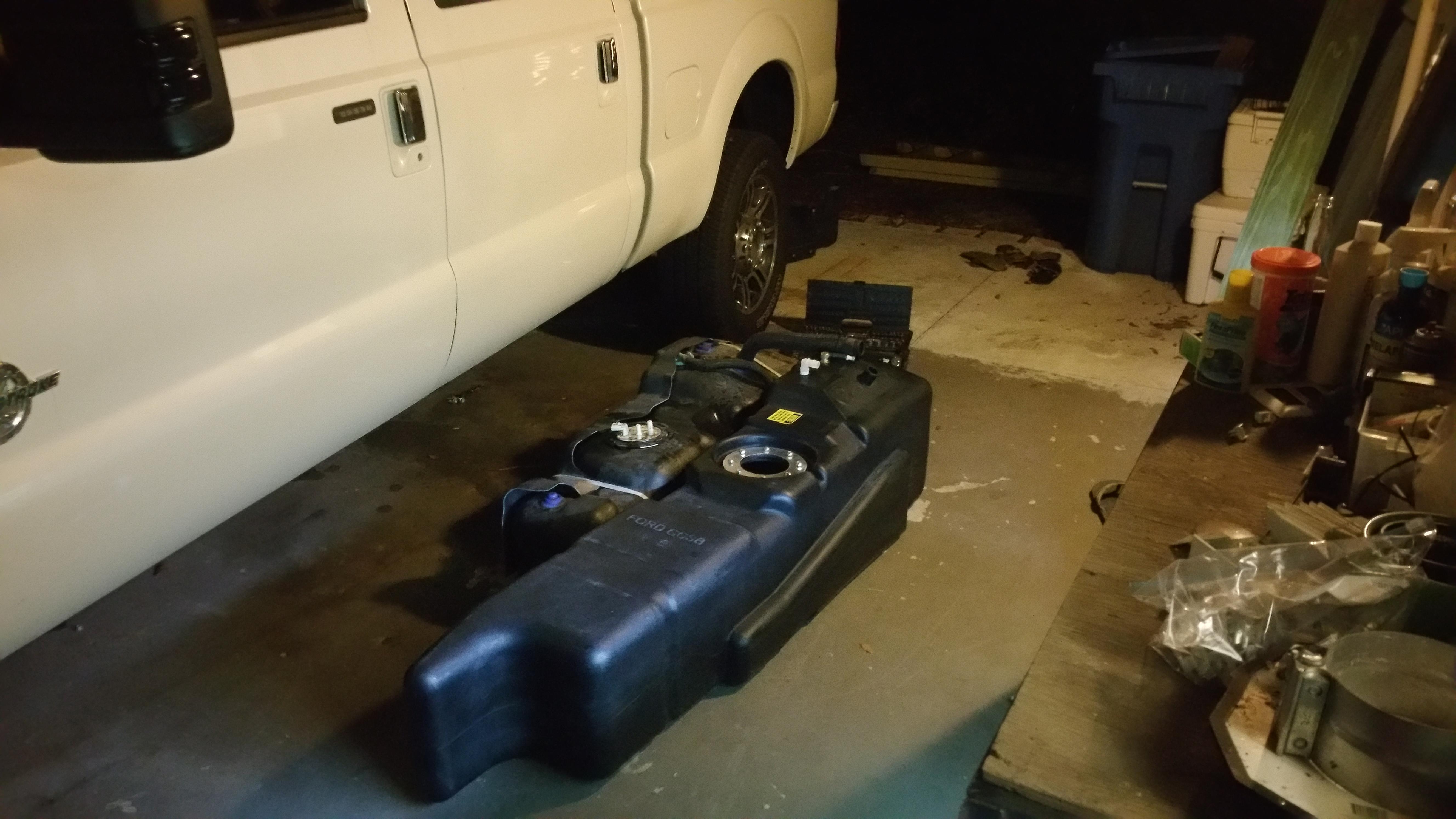

Well I just got home from offshore. Guy at shop was right and I will not be able to mount the PMF bars with the Titan. I will do some measuring and see if it is possible in any way to get them to work and then see about ordering some customs ones from PMF. Other method will be taking Titan tank out and get a Transfer Flow.
You can see where the Titan has a sump that comes out even with the bottom of the frame rail. So will have to do some engineering to get these to work.

Thats the first I have seen a tank shaped like that. Depending on where that falls on the frame rail (front to rear) it will almost definitely have some interference with the mounting location. Spacing further out away from the frame may cause an issue with the AMP steps as well. This might get tricky. Like I said on the phone though, Im happy to help however I can.

That tank hangs way low.... that's insane. Offroad trip and it would get ripped out.

Yeah, did a lot of Googling and have not found another one with the bulge for a 2011+ Super Duty. Called Titan and they say that is the newest design but they still ship some of the older ones too. Tank is about 6 months old. I have the Transfer Flow in the garage and may get it installed before I head back offshore, if not will have to do it when I get back in.
Appreciate the help and looking forward to getting everything finished up.
