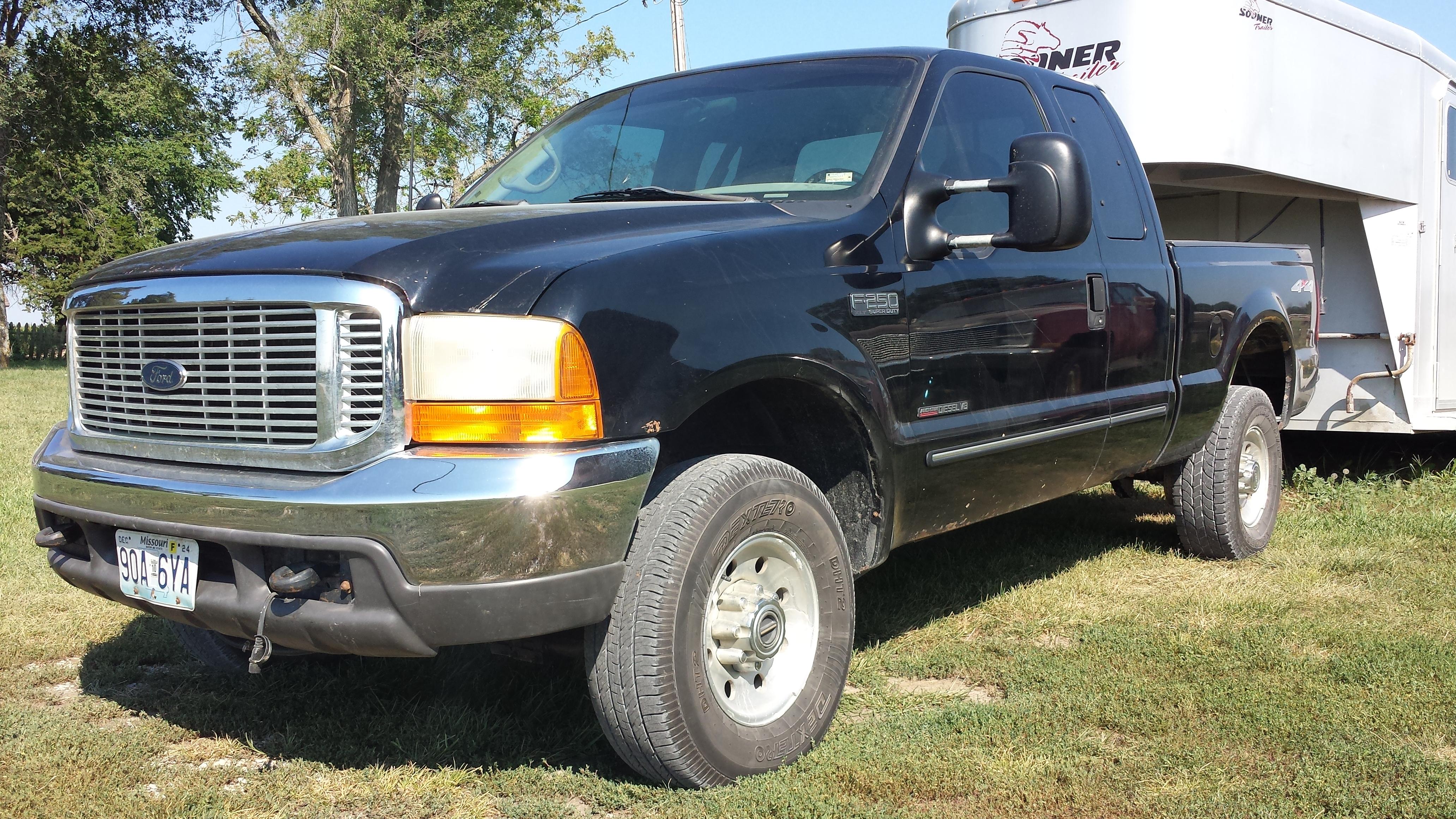

Well here is my project, I owned this truck before about 6 years ago and my dad bought it from me and he bought a new pickup last week and old blackie as my wife calls it found its way home to me. This will be a slow process but mechanical first.
First off the whole front end needs rebuilt, axle internals are fine but ball joints, wheel bearings sway bar bushings tie rod ends shocks everything needs replaced along with all brake components, rotors, pads, and possibly calipers.
Also curious about front springs, you can see how bad the front end rakes down, rear springs seem fine and have about a 3 and a half inch difference from front to back was thinking about doing pro comp 22210 springs in the front end, anybody used these and can the rest of the front suspension stay stock with them?
I would like any and all constructive opinions, probably will start fixing rust and a few dings and looking for a new tailgate and new mirrors, passengers side mirror is trashed, if anybody has a line on reasonably priced mirrors and tailgate let me know, here is a picture of the truck after spending 20 bucks getting it reasonably clean.

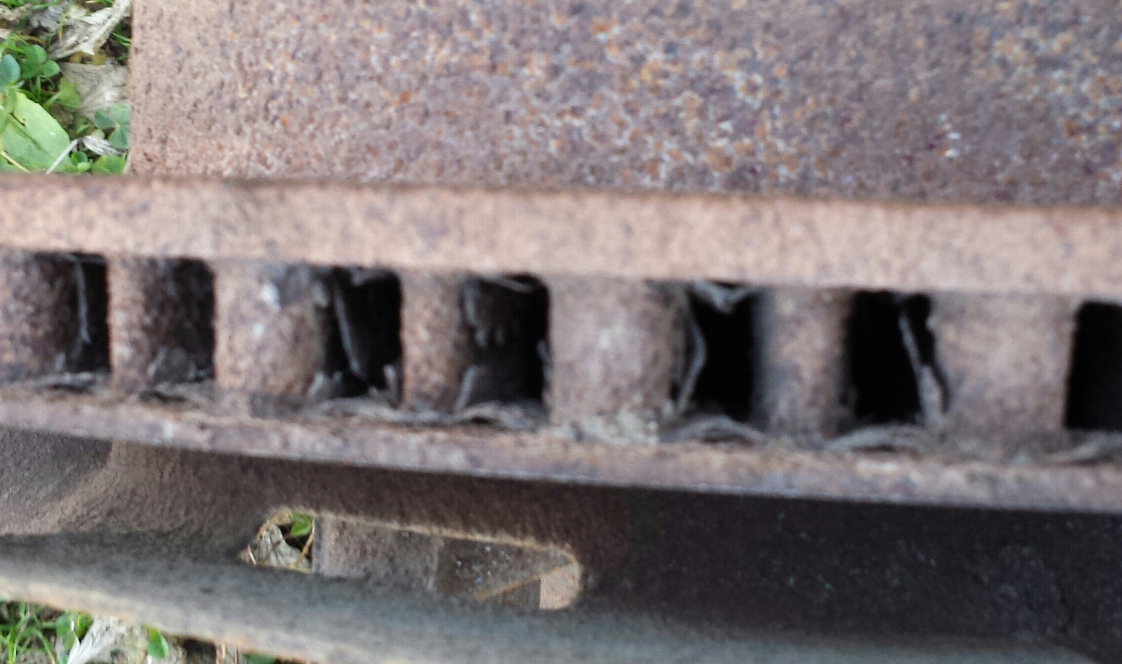

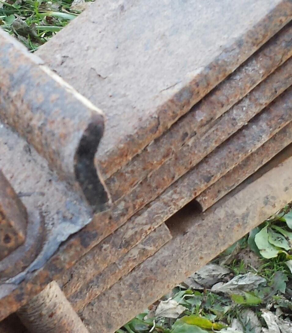

I found a set of 2003 f250 4x4 axles with 95k miles on them for 500 dollars. Seems like a good deal and a cheap resolution to rebuilding my front end and replacing all my brake components front and rear. Axles are complete with leaf springs and sway bar. Brakes look like new and calipers move freely, is there any way I can somehow check ball joints and wheel bearings? The axles are on the ground btw. Please give me opinions on this, thanks.

It didn't change the ride at all for me with the springpacks and it definately won't with hangers and shackles. No modifications were needed, the kits come with center pins. I would recommend the hangers and shackles way before the mini pack though. And btw, late 99-04 were the same front leaves. If you can find x-code front springs, it will lift it up as well. And sorry I cant help on the axles. Looks like a good deal even if you have to do ball joints and wheel bearings because you can sell yours for a pretty good price im sure.
