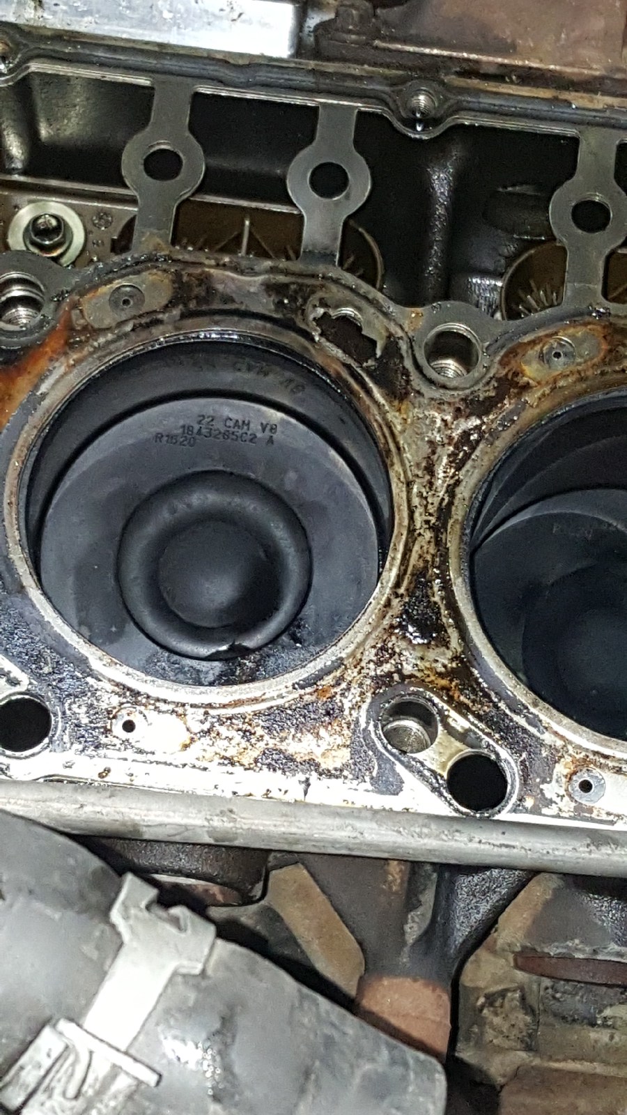

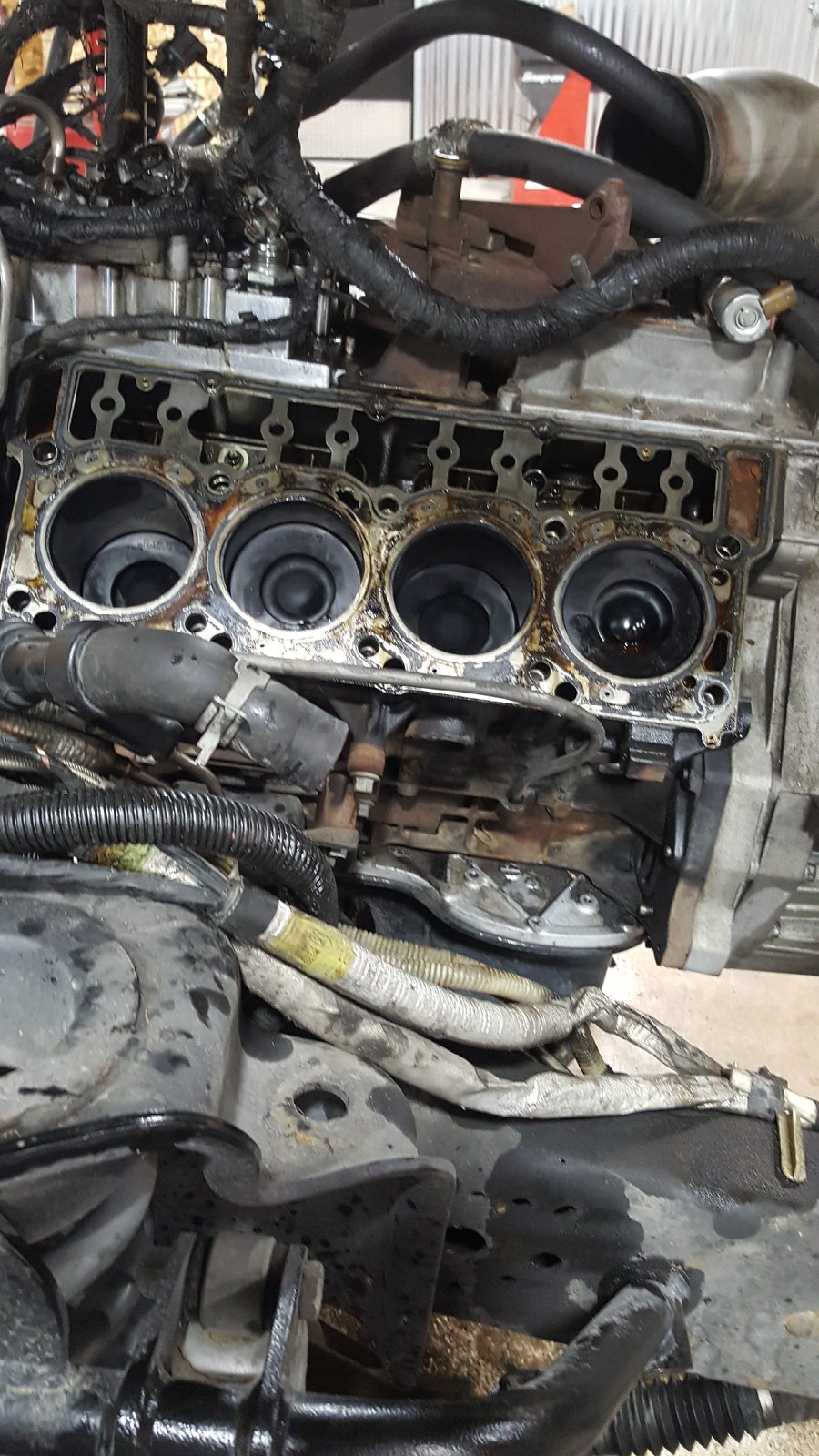

Here is the gasket. . See on number for up top where the gasket is gone...

Hmm. I have never seen a gasket fail like this. You said it's O ringed too? Maybe have the depth of the ring checked, thinking maybe it's the cause here

Have a look at that piston in #4 where the gasket blew apart.. didn't that look like a piece is broken off!!? What do you guys think.. is it safe to run it?
