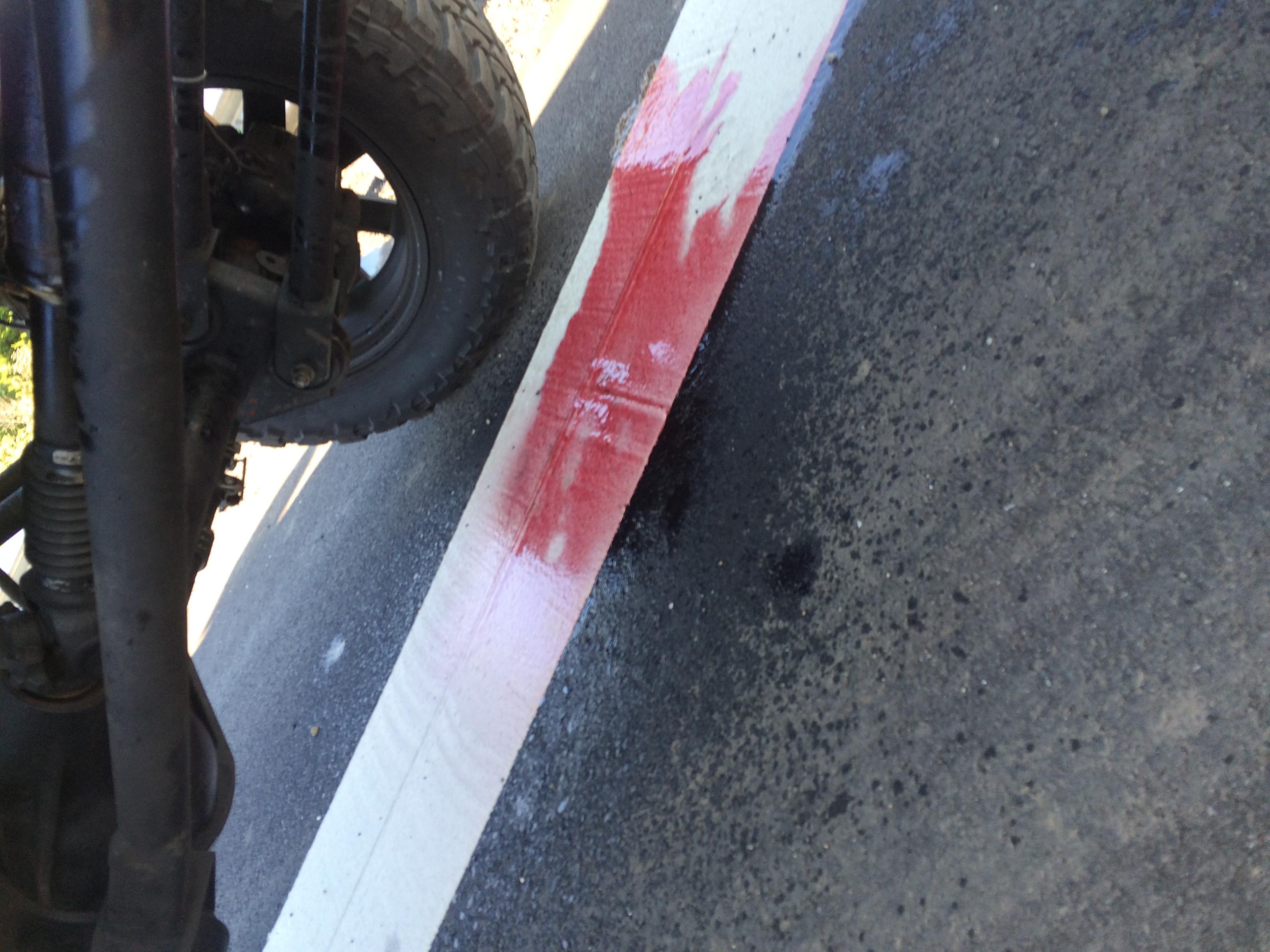

My truck is a 08 cclb tuned and ******d 14" lift 40" tires and 411 gears it has trashed the trans and/or torque converter over 10 times I have had 2 separate reputable trans shops work on it. I have ran *******, Kem, H&S, and gear head tunes and all have been loaded when a trans was trashed. Im running gear head tunes now that are written for my trans build and I blew something yesterday the wrench came on the dash I pulled over and all of my trans fluid was under truck

The most common problems have been snapping shafts, and destroying torque converters generally its large bang, this time it hasn't been taken apart yet but there wasn't any bang or snap truck was driving fine the wrench came on the dash it unlocked the converter I pulled over looked under the truck and all over the back was covered in trans fluid, my current trans shop thinks it was just the front seal blew out.
current trans build has: 5 Raybestoes red clutches and kolene steels in od and intermediate, 7 raybestos red clutches and kolene steels in direct, stock epc and direct solenoid, trans go regular shift kit, and billet converter.

Yeah I think I do finally have the tuning right with the truck now that its running gh tunes. Nothing banged this time all that happened was the wrench came on while I was on the highway in od converter locked I pulled over when the wrench came on and smelt trans fluid right away then saw what was left of the fluid pouring out of the trans. its apart now and the reason it lost all the fluid was a cracked weld on the hub of the converter and that's just my luck......... but at least nothing cooked or snapped this time
