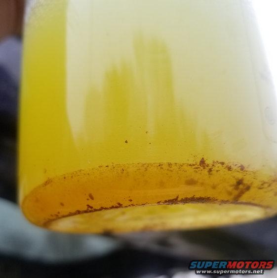

Baldwin post pump filter and wix pre pump.
pic of what came out of the prefilter.
damnit.

fuel from the post pump filter appears cleaner, but almost as cloudy.
Sent using Tapatalk
Eeeww, id drain the fuel, change the filters and put known good fuel in and go from there. Most 7.3 tunes idle around 550.

Bad fuel can cause a lot of issues. I have been there and i had another guy that i was trying to help and i was banging my head off the wall trying everything and looking at everything on my otc scanner and in the end, he realized that he put gasoline in it....

bad fuel was the one thing that never crossed my mind until a buddy brought it up. so it's the absolute last thing I've looked at.
and now I'll be forever paranoid about every single gallon.

If that mess was in the filters it's in the tank. I'd drop the take and clean it out when empty. I've tried other filters I keep going back to oem. Glad it wasn't to serious an issue for you. When I'm on the road I get fuel at truckstops they pump so much and have better filter systems just watch which pump. Don't want def in the tank that would be very bad.

I dropped it and cleaned the whole fuel system from tank to fuel rails. Clean fuel made an improvement but it wasn't back to normal.
still underpowered and lugging under load.
being the only part of the fuel system that hadn't been changed or altered in some way, I ended up changing the injectors and that's what fixed it.
