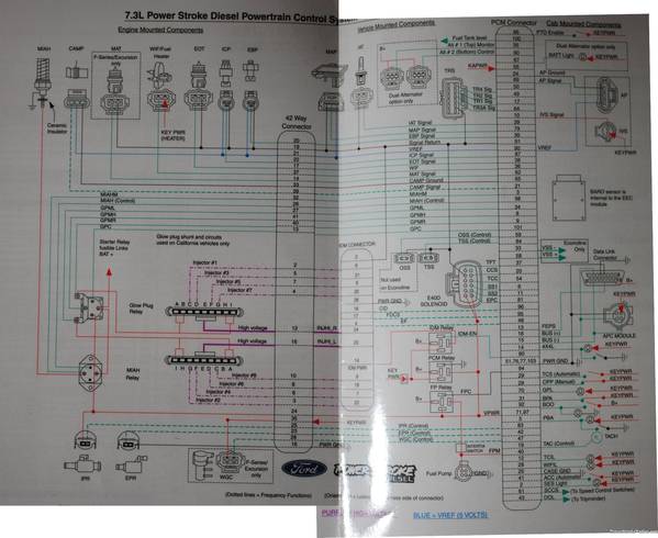

My favorite wiring diagram.
Tom, can you throw this in the Library, if it's not already there.
Tom S
3,365
Andy do you have a larger version of that. I think that is just the medium size thumbnail and it does not pop open.
I will library it if we get it right.

I have the full size one saved in my photo album here, but when I attemp to past it in here, it adjusts the size.
