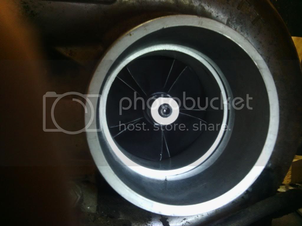

Is this wheel still good enough to run?
Jan 31, 2014 #1 Redpower Member Joined May 24, 2011 Messages 308 Reaction score 0 Location Central Iowa Is this wheel still good enough to run?
Jan 31, 2014 #2 Magnum PD Active member Joined May 18, 2011 Messages 9,566 Reaction score 7 Location VA Need to see more of the wheel
Jan 31, 2014 #3 lincolnlocker Well-known member Joined May 25, 2011 Messages 27,884 Reaction score 150 Location Central Michigan i wouldn't

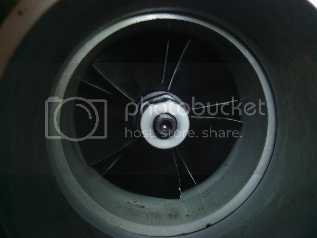

Jan 31, 2014 #4 Redpower Member Joined May 24, 2011 Messages 308 Reaction score 0 Location Central Iowa Magnum PD said: Need to see more of the wheel Click to expand... I don't think I can get any better pic of it with out taking it all apart. Turbo has 114k on it and shows a little wear on the edges with a small chip on one fin. I am leaning toward leaving it as is.
Jan 31, 2014 #5 MossBack Member Joined Aug 22, 2011 Messages 934 Reaction score 1 Location UTAH any in and out play? or contact with the housing? I have seen much worse. I would run that in a instant!
Jan 31, 2014 #6 Redpower Member Joined May 24, 2011 Messages 308 Reaction score 0 Location Central Iowa No shaft play. Feels good and tight.
Feb 1, 2014 #7 79jasper Active member Joined Feb 2, 2012 Messages 2,685 Reaction score 4 Location skiatook, Oklahoma Better than mine. Lol Sent from my USCC-C6721 using Tapatalk
Feb 1, 2014 #8 MossBack Member Joined Aug 22, 2011 Messages 934 Reaction score 1 Location UTAH Red I would run that everyday with no hesitation... Sent from my iPhone using Tapatalk 2
Feb 1, 2014 #9 lincolnlocker Well-known member Joined May 25, 2011 Messages 27,884 Reaction score 150 Location Central Michigan Better yet, what might have caused it and where did it end up? live life full throttle
Feb 2, 2014 #10 89 Stroker Active member Joined Feb 3, 2013 Messages 1,317 Reaction score 0 Location Southern Cali iv seen worse also , just run the thing
Feb 3, 2014 #11 Redpower Member Joined May 24, 2011 Messages 308 Reaction score 0 Location Central Iowa Going to run it. I've got too much in this repair project already.
