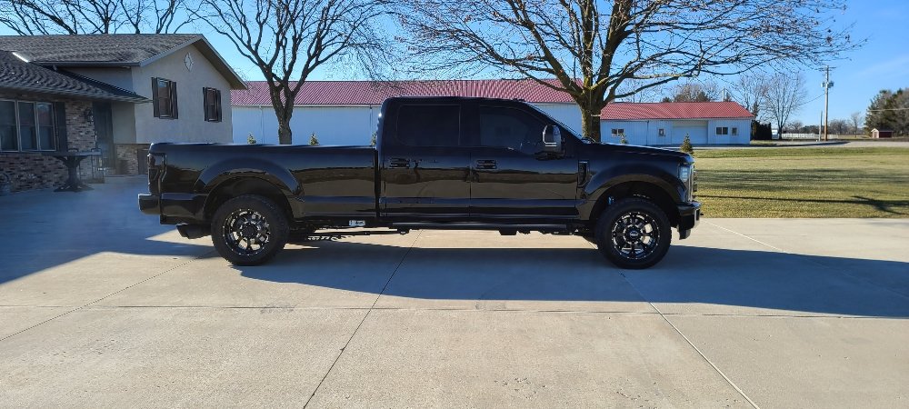

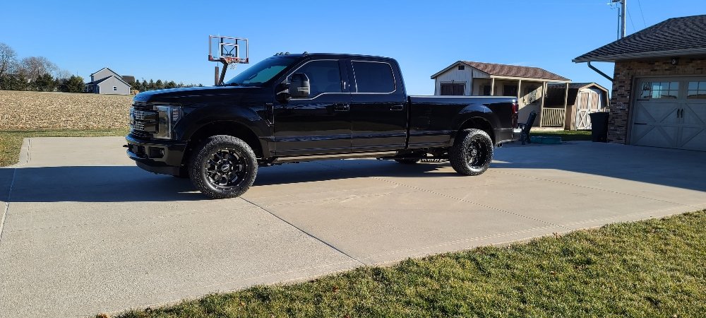

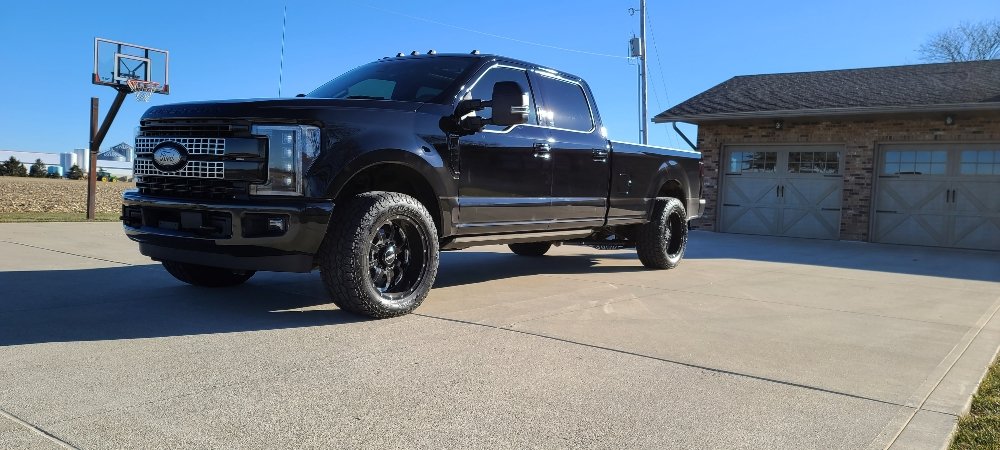

I have a 2017 F350 CCLB with 4800# front springs, no rear block (3" rear block) and PMF drop shackles set to 3/4" rear drop. 1.5" front drop and 3-3/4" rear drop.
I have almost 80k miles on my truck. I've been lowered with no rear blocks for over 60k miles now and have yet to have a driveline issue, my truck makes more power than most 17-19's now too and still zero driveline issues. However, I have a lot of suspension mods being lowered. KING Racing 2.5" reservoir custom length shocks, OUO 3-link ALA'S, OUO Traction Bars, Hellwig Big Wig Rear Sway Bar, and Airlift 5000 rear air bags. I also have a full steering linkage kit from PMF but I don't really think that matters too much being lowered or stock height, I did it because stock FoMoCo steering kept going out on me.
Clears my 7'-0" garage by about an inch. And I have cab lights too. I still have my full leaf packs in too.
