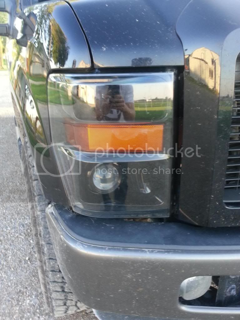

Not that hard to install, if I were too do it again I would dremel a bigger hole in the bucket to make setting the projector easier. The hole wasnt quite big enough for the projector to sit far back in the bucket. So I ended up using a tube of steel stik on each headlight to hold them in place. Then I used stainless #10 bolts and lock washers to bolt them down to make sure nothing moved. I then put a thin coat of epoxy on the back of the bucket where the projector comes through it. 2 years and hasnt moved at all
