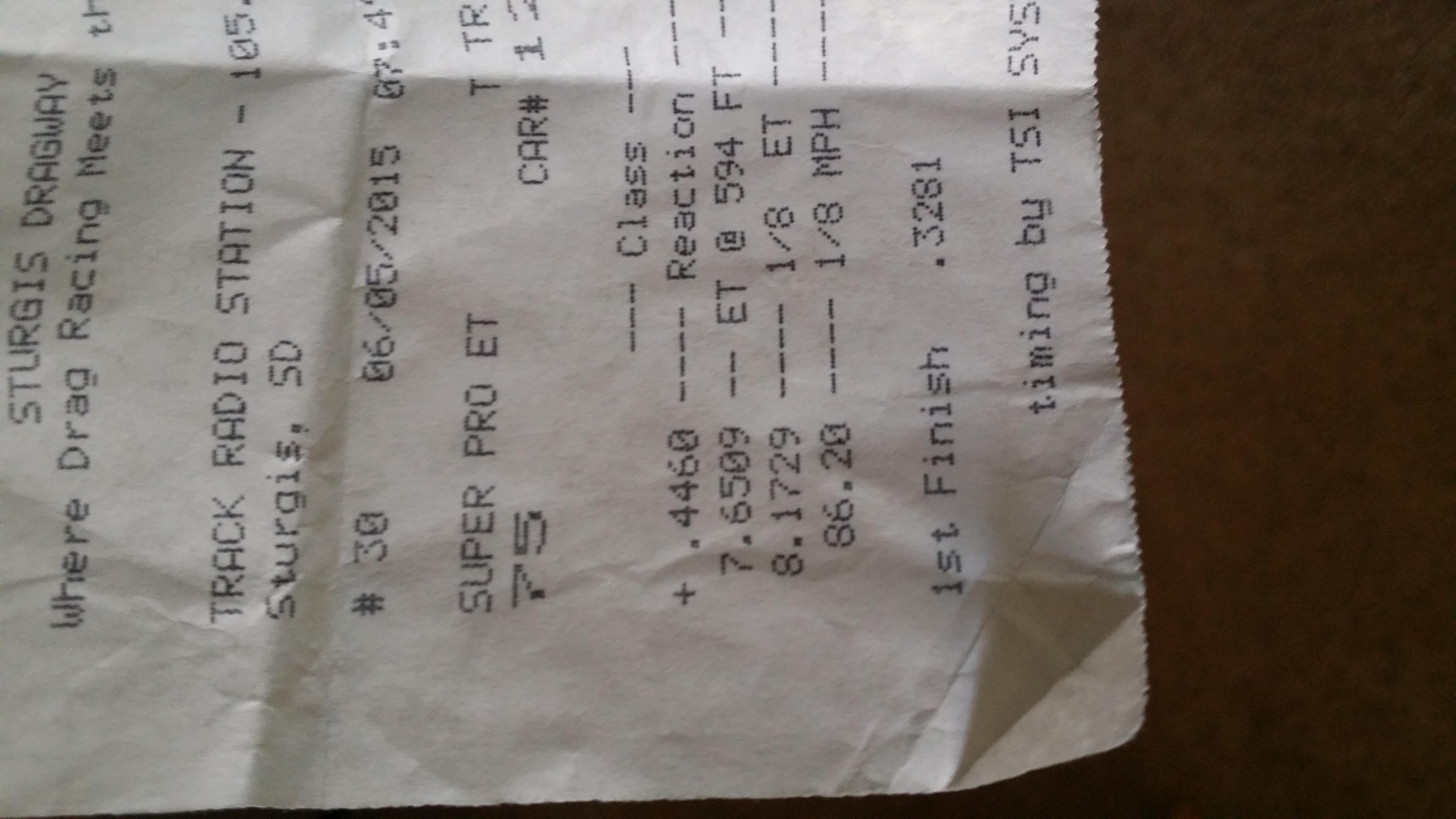

Hey guys, last night I went to a local 1/8th mile track and needless to say I'm pretty disappointed.
Last year with stock fuel and Industrial Injection drop-ins I was able to run a 7.9 with a weak 1.8 60ft.
Tonight, the best I was able to put up was a lousy 8.1 at 86 MPH.
Is there anything I'm missing?
Gate it opening at 65 psi on my H&S.
Boost is roughly 48psi, and truck his holding 26k rail the whole way down the track.
The density altitude was around 8,400 with the humidity 87%, but I would still think I should be in the 7.5s or7.6s with a decent 60ft.
Thoughts?

What was DA when you ran a 7.9? What MPH was it at?
DA of 8,400 ft and 87% humidity are about the absolute worst conditions to make a pass in. I wouldn't even consider any times made in those conditions unless that's how it is every time you race.

I don't have the slip for the 7.9 but it was 84mph.
DA that night was probably 2800 at the same track.
I never would have guessed it would have that much affect on power.

You picked up 2 MPH on the new run so you were making more power even in those conditions. More seat time will get you better results on the ET side of things.

Don't know a ton about drag racing rigs but in our dragster DA and humidity is the first two things we look at when we are dialing the car. You picked up mph so it might have spun just a little at the line. Did you change the gear ratio? Larger or smaller tires?
