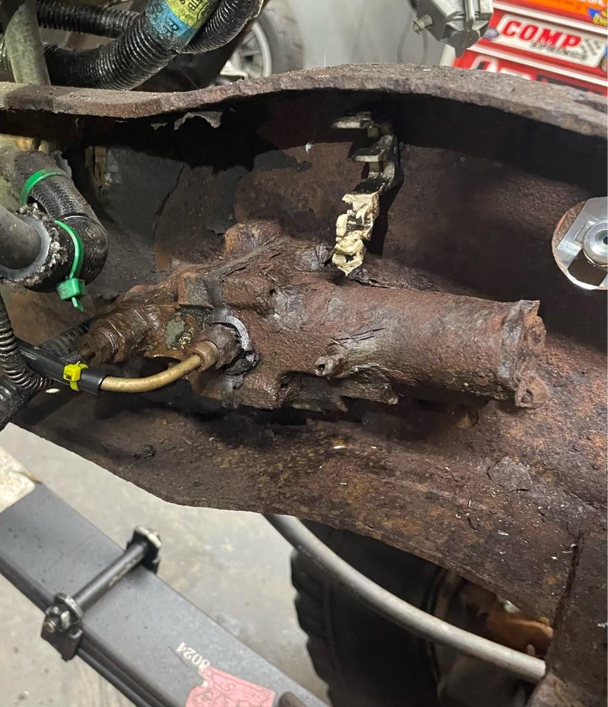

Drivers side inner frame rail.
Part of the brake system…
Electrical plug in the back and rear brake lines go through it.
I’d like to replace it while I’m in here
Thanks

That’s the rabs valve. Rear abs valve.
ABS ?
On the rear only?
Hmmm, I bought this truck new and wasn’t even aware it had ABS in the rear.
Question:
Can this be bypassed?
Its a 1995
I’m thinking if I keep it in place and plugged in/maybe plug the holes
The computer won’t know the difference

Yeah a lot of guys bypass it cause it was prone to cause a soft pedal. They would bypass internally and feel like a bad master cylinder

I’m not following
Are you saying if you bypass it internally,
It will make it feel like a bad master cylinder?
No, when they go bad they bypass internally and cause a soft pedal. If you bypass it externally there will be no issues. So if you disconnect the lines and put a junction to connect them and then bleed the brakes, it will be all good.
Ok gotcha.
My plan is to leave it in place,
Plug the 2 ports.
And run a new line from the master to the rear brakes.

Just remove it, along with the abs light bulb....
Sent from my SM-G988U using Tapatalk
It’s not hurting anything sitting there.
And if leaving it plugged in doesn’t trip the light, that means I don’t have to take the dash apart looking for the stupid ABS bulb.
But if it decides to throw the light anyway…. I guess I will have to look for the bulb.

True. Looks like it's halfway to rusting off anyways.
It would be hard to find nowadays, but the F-SuperDuty had a bypass from the factory.
