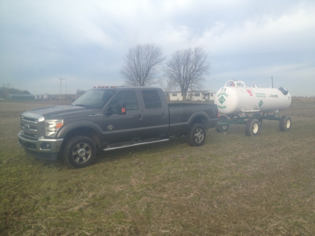

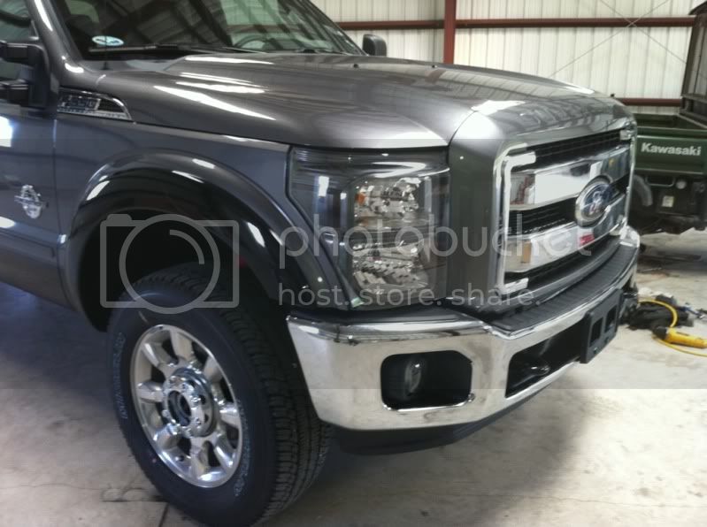

Lets see pics of your painted 2011+ headlights. And where u got em painted. I'm debating between black or color matched for my truck ImageUploadedByTapatalk1357758436.867573.jpg

Color match looks great. Tones down the flash of that front end so much...especially with the painted shell.

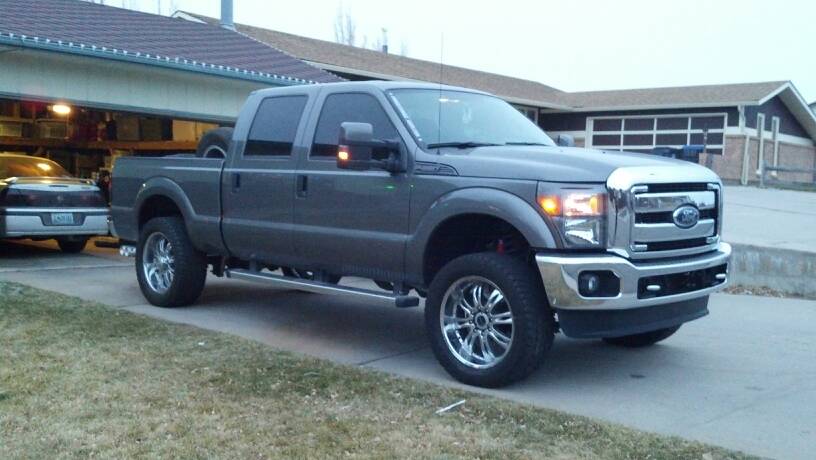

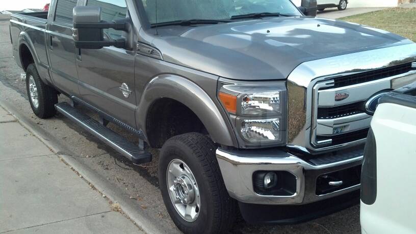

My vote is paint matched

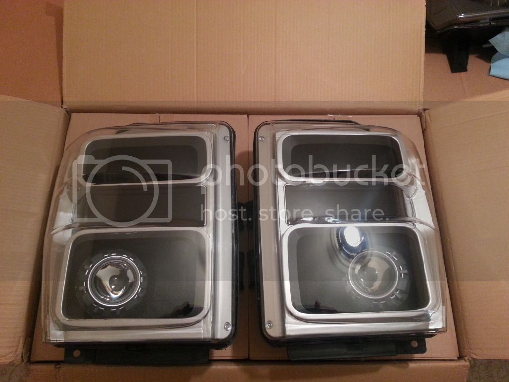

I'm always a fan of color matched......along with retrofitting projectors and fully painting everything. I'll be doing a set of these soon with projectors, full paint, some show stuff, etc..
