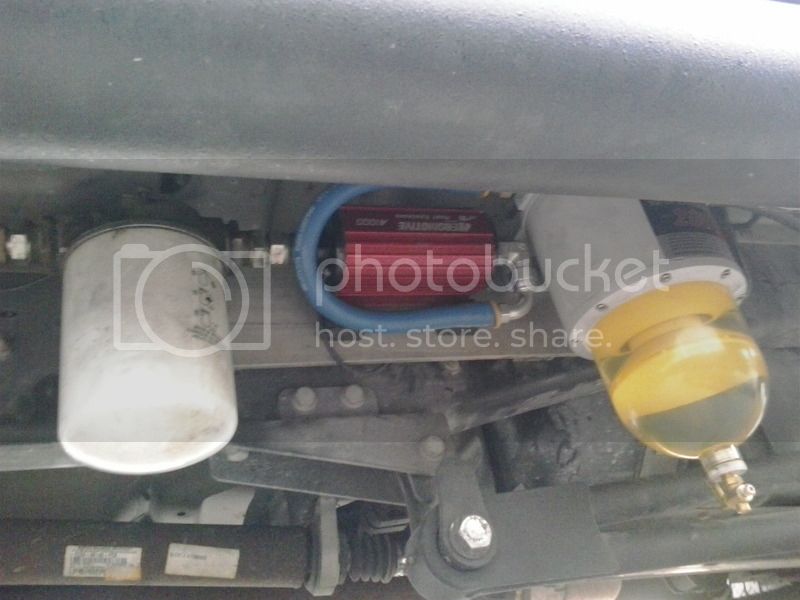

Do you have any pics of the setup? Would like to see how you made it all work
HOOV3R on here shows in one of his build thread parts/carrier on how he built his IIRC.

Jonnydime
Jun 26, 2012
2,319
8
this is the only photo I have of it.
