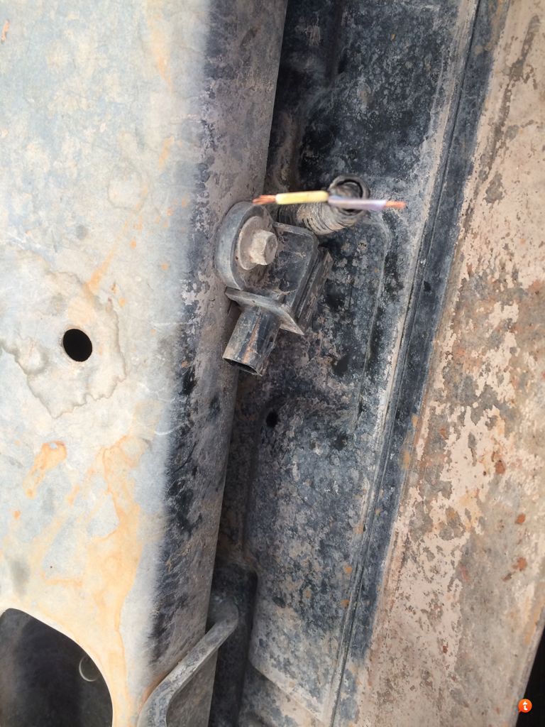

Are you throwing any codes besides what we saw last night? Pics of that line not hooked up perhaps?
broke connector that I found
