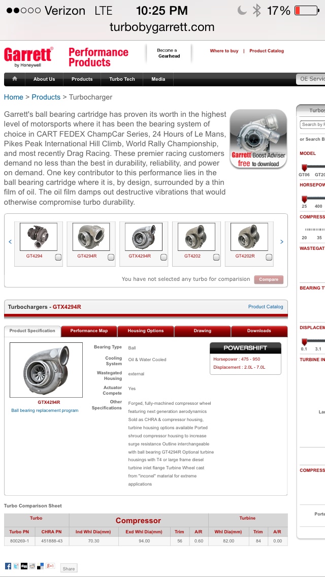

ImageUploadedByTapatalk1412043980.553568.jpg Atmo
ImageUploadedByTapatalk1412044032.204669.jpg primary
Let me hear some opinions on this setup. I'll have dual gates

Yea so if you're using those, this is basically going to be one of the most bad a*s 6.4s ever. You'll be on par to be one of the fastest and highest hp 6.4s. If you plan on street driving a lot, I'd urge you to go smaller on the high pressure. But if this just a toy then they will probably be perfect and will hit hard once spooled.

I don't mind it being laggy, I may bump the primary down to a 65-67 range. My mission is for this thing to break the tires loose on the interstate doing 85 plus. I want something that has stupid power. This should be the setup lol. Maybe a .120 shot too?

What about the Garrett compound kit for sale in the classifieds? 800-850 on fuel setup all day.

Somewhere to start. Seems damn reasonably priced.... But you could over fuel it you think? I guess gated it'd be fine. I think it's a damn good starting point.
Over fuel it, .120 shot, and tune those gates perfectly and I'll have something that destroys tires. Not transmissions and motors

Gt4094r be a better hp turbo than the Gtx4294r. Comp us slightly smaller but the turbine is way smaller so it'll actually light. There is someone running these big turbos on a built 6.7 and it didn't light very well from what I heard.

Good point. 70mm HP would be a little to big. Do you have a connection on Garrett's? Those things are$$$$
