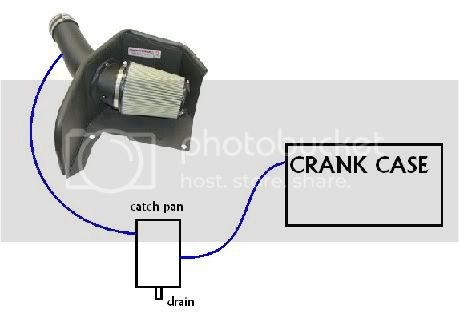

tell me would this work...im thinking of making my own catch box with a drain on the firewall..re-routing to that catch box and then the exit going back to the intake..that way theres still vacuum but catching it first..like adding a middle man..would this work?
tried a description on paint
Yes i have seen where people do that, and there are kits available that do it that way. Just be careful that there is no low spots or anyway to pressurize the crankcase.
how low?
the drains are closed until you open them to drain fluid
it's not open to the atmosphere so no filter required
