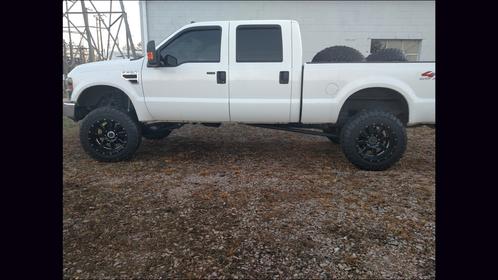

Couple pics of White Power before and after I upgraded to 20x12s.

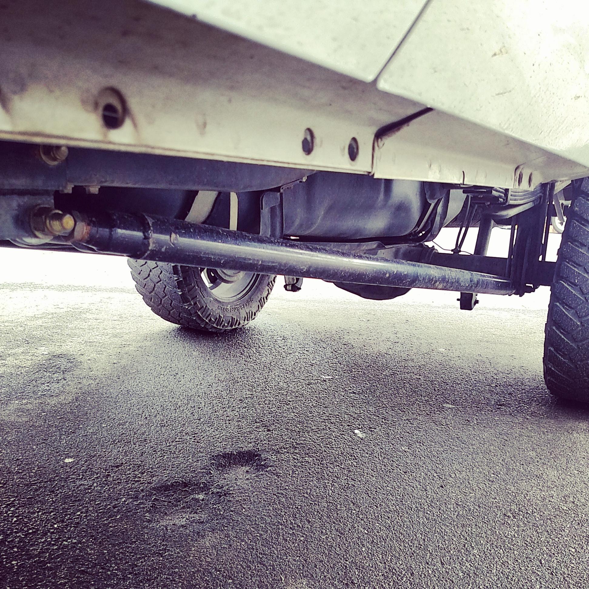

Newton Fat boy bars.....night and day difference. Getting painted white while motor is getting built
PS....the blocks are custom made 7" to work with the bars...and are for sale. Dropping her down closer to stock height.
