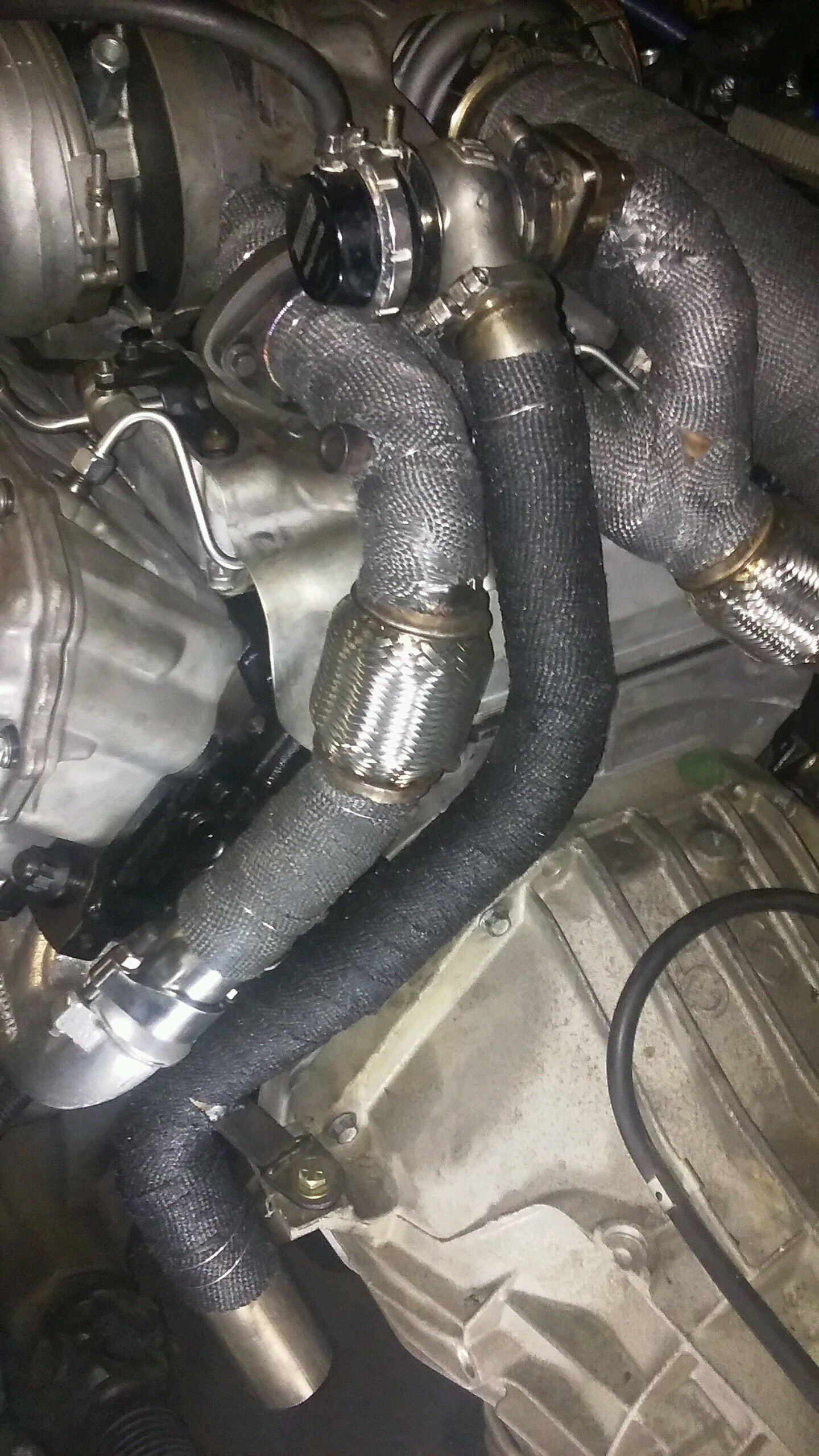

Got the down pipe done.
Now accepting ideas for a wastegate pipe....not sure if I should put an egr pipe back on and put the wastegate below kinda like the h&s kit, or take it straight out the back and go down beside the trans with the gate mounted as the egr provision pipe

Seneca, MO
This is a strong candidate here. Cut out the bellow and just do a straight pipe down passed the manifold
