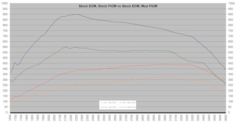

Stock: 329 HP @ 3050 RPM & 598 Ft./Lbs. @ 2150 RPM
Mod: 440 HP @ 3050 RPM & 899 Ft./Lbs. @ 2250 RPM
Test Vehicle Parameters:
2004 F-250 Single Cab 2WD
Stock Exhaust (including Cat), Stock Airbox, Head Studs, EGR Cooler Delete
ECM strategy VXBC6N4
FICM strategy ARZ2AL10 (which includes mild Inductive Heating.)
(This example is with a stock ECM strategy.)
(click on image to enlarge)

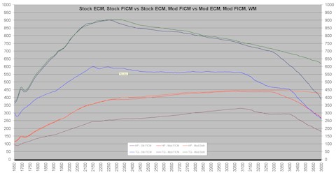

We're talking about 111 HP and 301 Ft./Lbs. (peak to peak, with 135 HP and 307 Ft./Lbs. max gain) of certifiable crazy! Plus, this tune still runs the "mild" Inductive Heating Strategy so you won't have any cold start issues. Keep in mind that this is on a BONE STOCK ECM strategy. For improved high RPM performance, you can combine this with a modified ECM/TCM strategy. Take a look at this plot:
(This example is with a modified ECM strategy.)

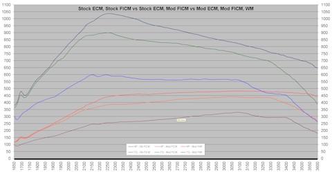

As you can see, we've pretty much maxed out the capabilities of the injectors, so we needed a little extra "juice". Since we're already crazy (and we just happened to have it), we also ran a few runs with our Snow Performance Water Meth kit. We used their 49% methanol "Boost Juice" and are running the 175ml economy and 625ml power nozzles. Here's how it sized up:
(This example is with a modified ECM strategy and Water/Meth.)
Yes folks, that's 482 HP @ 3075 RPM and a whopping 1035 Ft./Lbs. @ 2250 RPM. On a 280,000 mile engine!!! Have we got chrome-moly cajones, or what? :doh:
