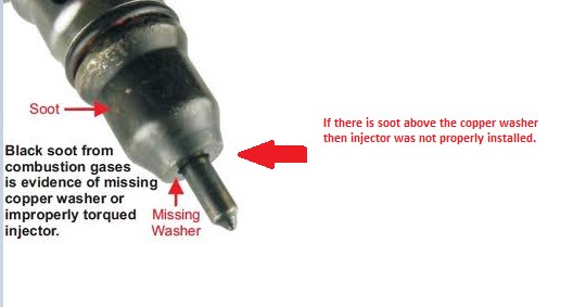

sounds like you lost an injector nozzle, or possibly (if installed recently) you have an injector not seated properly.
look for carbon up above the copper washer, similar to this

If it is a injector nozzle or a cracked injector cup would it knock real bad to ?
a cracked inj CUP would have your diesel fuel pissing out of your coolant tank...
a cracked inj NOZZLE (or poorly seated inj) would have your diesel fuel pissing into your cylinder..effectively hydro-locking it every time that piston comes up to TDC.
don't drive the truck, you'll burn up a piston in a hurry.
