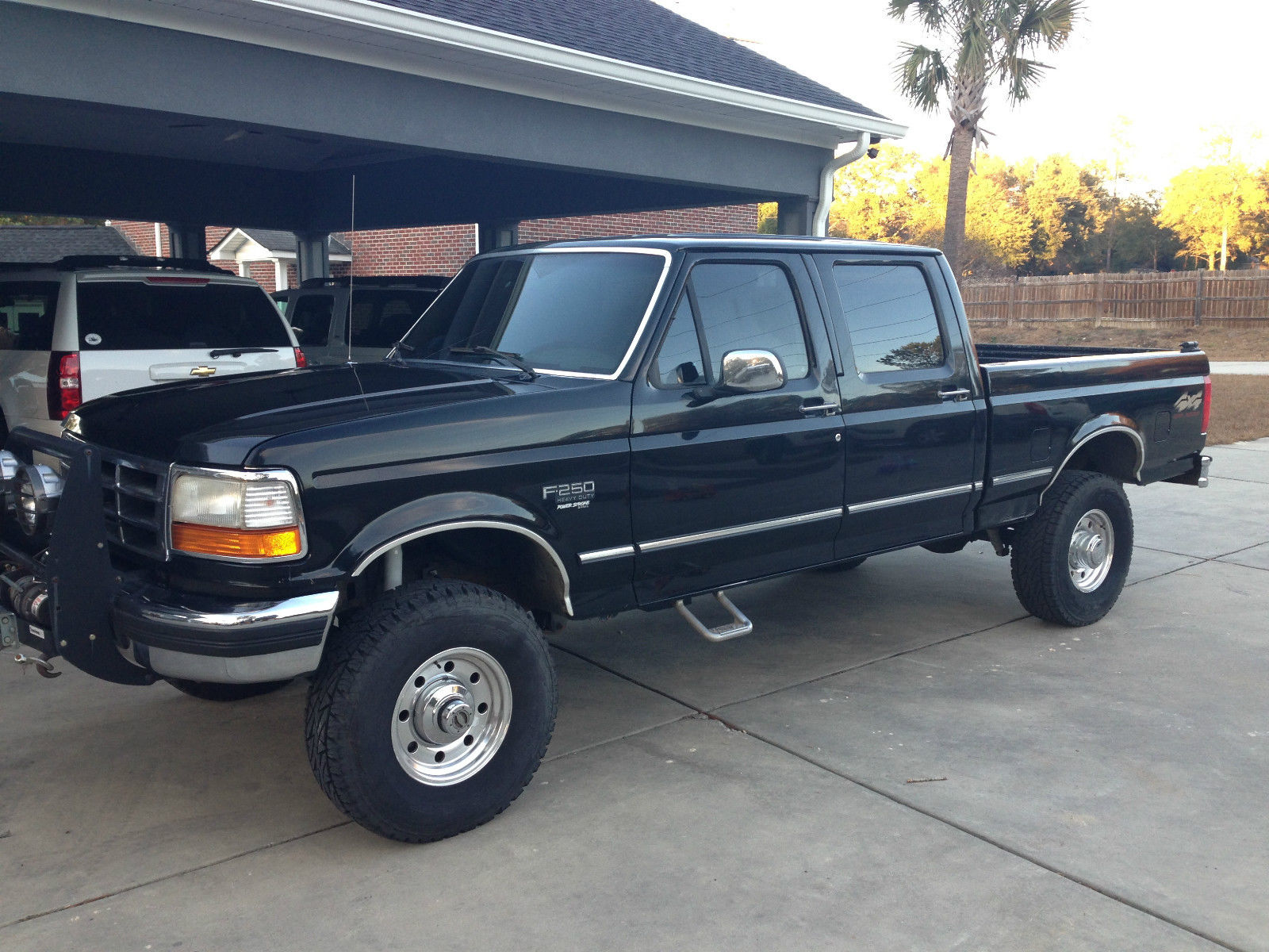

Here is mine with the V and B codes
If you can tell from that pic. If not Ill find another.

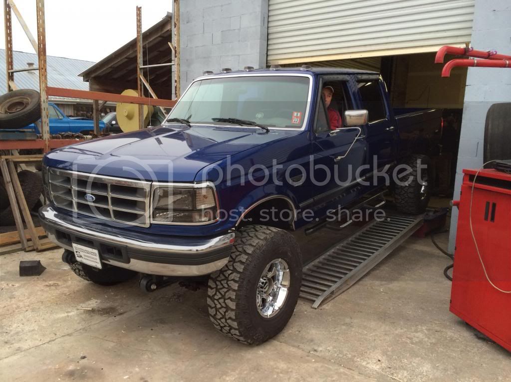

Cool I'll give him a call. That's a good looking truck love that color. Here is my truck I just picked up.[
ATTACH]36677[/ATTACH]
