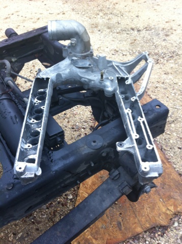

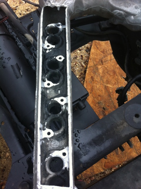

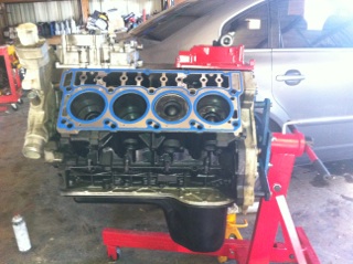

Then I decided to port the intake

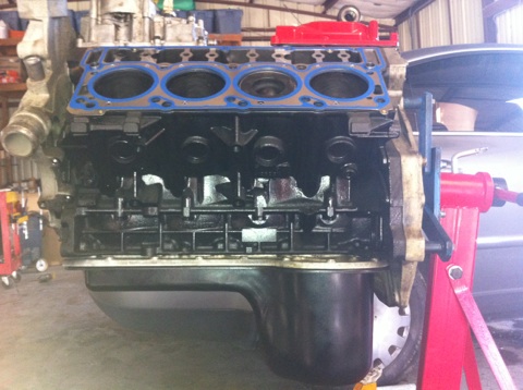

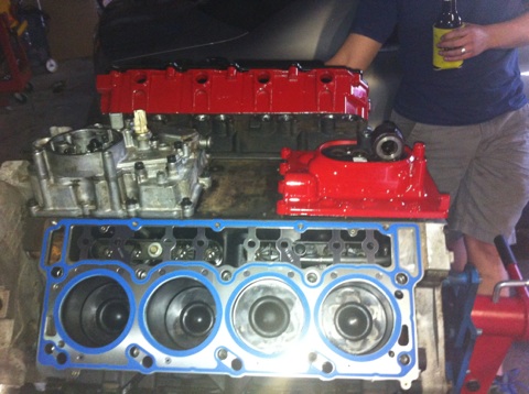

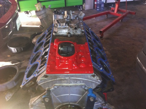

Here are the previous pictures that have photobucket links. I was told some people could not open them.
They should be in order.

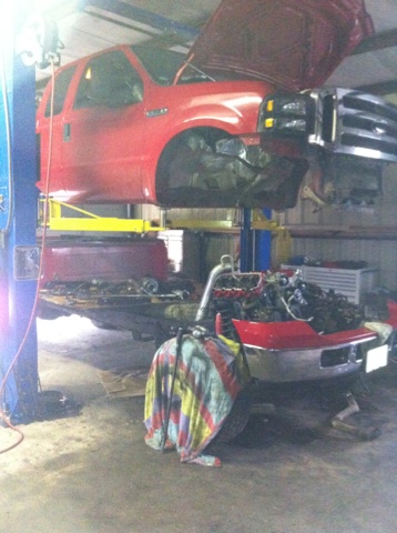

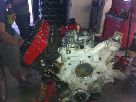

Truck sitting on the lift for a month and Engine build starting.

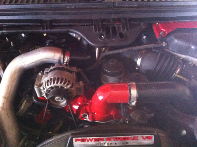

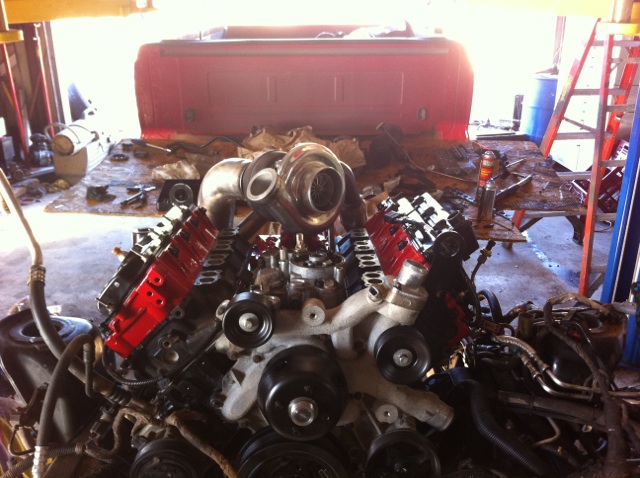

Heres the 66mm Turbo sitting on the CED divided t4 up pipes.
The kit went together good, had a slight clearance problem with the downpipe hitting the passenger side up pipe. With a little persuasion of my bfh on the downpipe, I was back on track. I was happy about my Magnaflow 4" because it was a true 4" all the way to the turbo, until this point, now I wish I had ordered an MBRP.

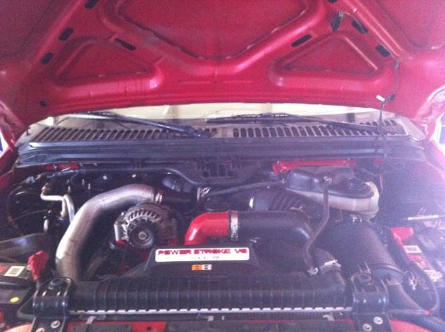

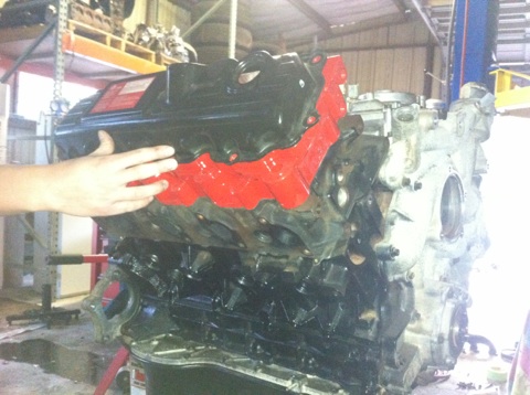

Here she is all put back together minus the coolant filtration

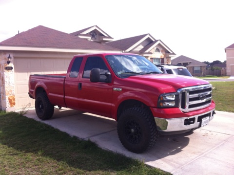

Every new truck with a new engine should get some new shoes, dont you think?
