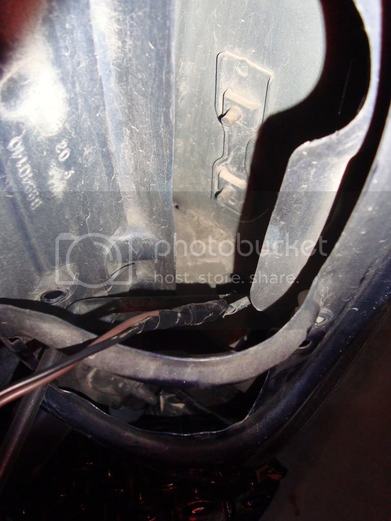

Wire the new socket that you had to trim onto the factory harness. I do not think that there is a certain way the wires go since it is only a 2 wire system, one is hot and one is ground. I soldered the wires together and i taped up the connections. I would reccomend using heat shrink tubing but i didnt have any at the time. Here is the connection. Also be sure that when you go to put your new light back into place both of the sockets are on top of the brace in the tail light hole.

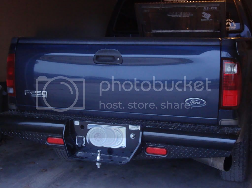

Here are some pics of the final product.
As far the actual light output I think its about the same as the 99-07 tail lights but I do think that these 08 lights follow the body lines a little better and give the truck a more stylish look.
