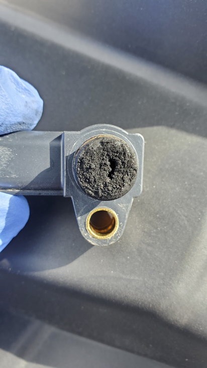

Have you pulled the map sensor off the top of the intake manifold and cleaned it? I've seen some completely caked over causing all sorts of weird symptoms (minus whining).

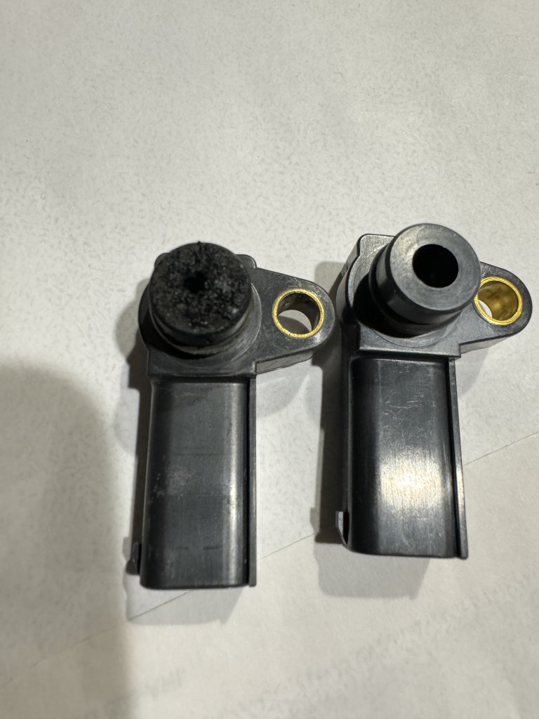

I went ahead and just ordered a new MAP sensor. It just came in so I will switch them out tonight and take a pic.

Got the sensor switched out last night. Initial reaction is the truck drove completely different. Wanted to make sure after a day of driving and yes, this changed the entire attitude of the truck. I can actually hear the trubo spinning up now. Snappy throttle response and no more stinky exhaust.
Thank you all for the help!!!
Sweet!
When it would plug up on my Duramax, it messed up regens, boost, shifts and mpg.
Check it every so often and hit it with some brakecleen.
