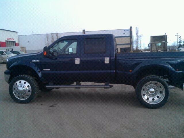

I have 10 on 10 american force adapters.
you have to machine the center bores of the rims to fit the adapters.
Demon
Oct 23, 2012
511
Alberta, Canada
You can see there how the 10on225 pattern interferes with stock bore of the 10on285 rim. It will still be a hub centric rim after its machined for the adapter, but theres no going back to use them with another set of adapters or on a big truck ever again.

If you go with the 10x10 adapters that inverts the stock studs you won't have to mill the rims like the American Force adapters.

Can you describe more detail. Or picture it. Because that would have been awesome to not have had to cut my center hole. But what's done is done now. I didn't know there was another option for 10on10 adapters.

Sorry I didnt see you asked. On the American force adapter you slide the adapter over the stock studs. The bore is larger due to casting and lug nuts facing out. This makes you have to bore the center if the rim to fit over.
The adapters I am installing require you to remove the factory studs and press them into the adapters inverted. They install back onto the truck and the stock lug nuts go on the inside.
I will snap some pictures when I get them installed. They are being made now and should be done in a few days.
