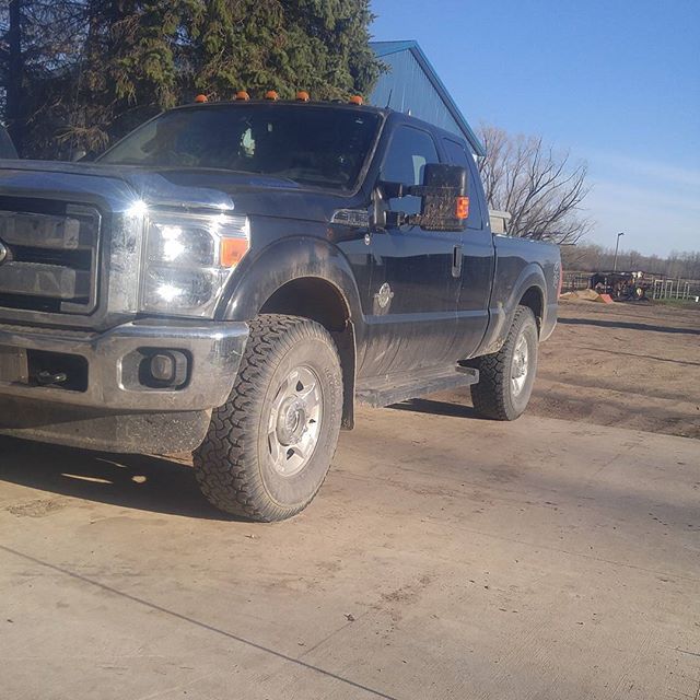

I'm running 325/60r20 on -12 offset with half inch spacers and I have very minimal rubbing. I've also ran 37x12.5 r18 on stock rims with rubbing at full lock and some on the mudflap at about 1/4 turn. It all depends on how much rubbing you can stand. I also ran 35x12.5 r18s on stockers when I got the truck with no rubbing.

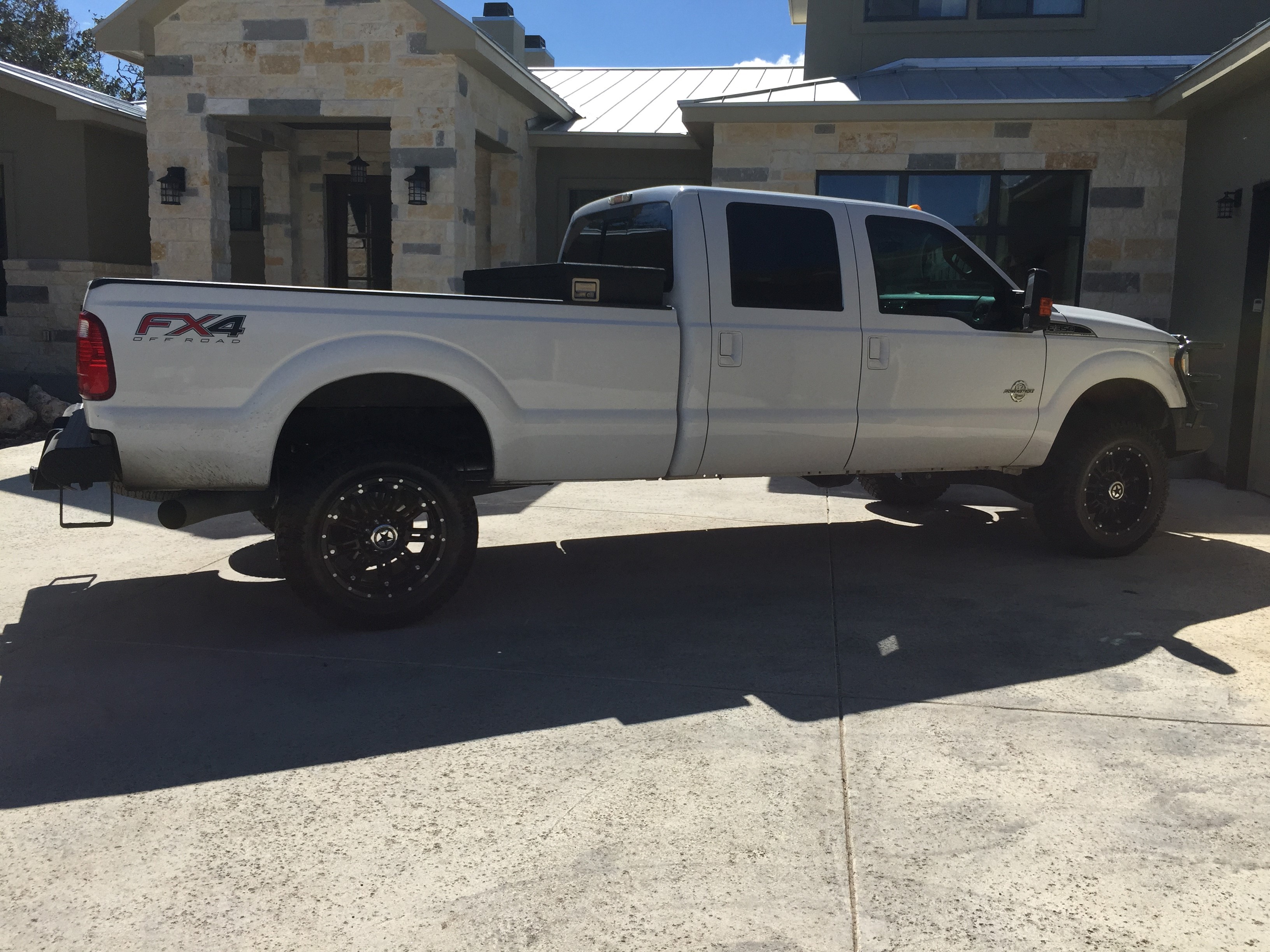

-25 offset puts the tires a smidge outside the fenderwell and makes the truck dirty fast but looks cool as sh*t and you can straddle speed bumps. I'm just waiting for my tires to wear out so I can get the wheels and new tires on. My truck looked best on 37s with the 6" lift but was too tall for my 5th wheel. Post pics when you get it all set up.
BTW, I agree with Sootie on 20x12 -44 and 33s..........

You don't like my truck...............? lol
Get what you want homie, that's why it is YOUR truck!
I say 37s
