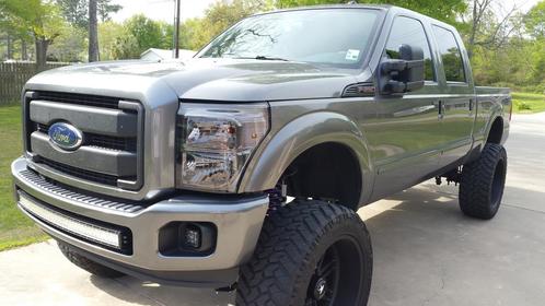

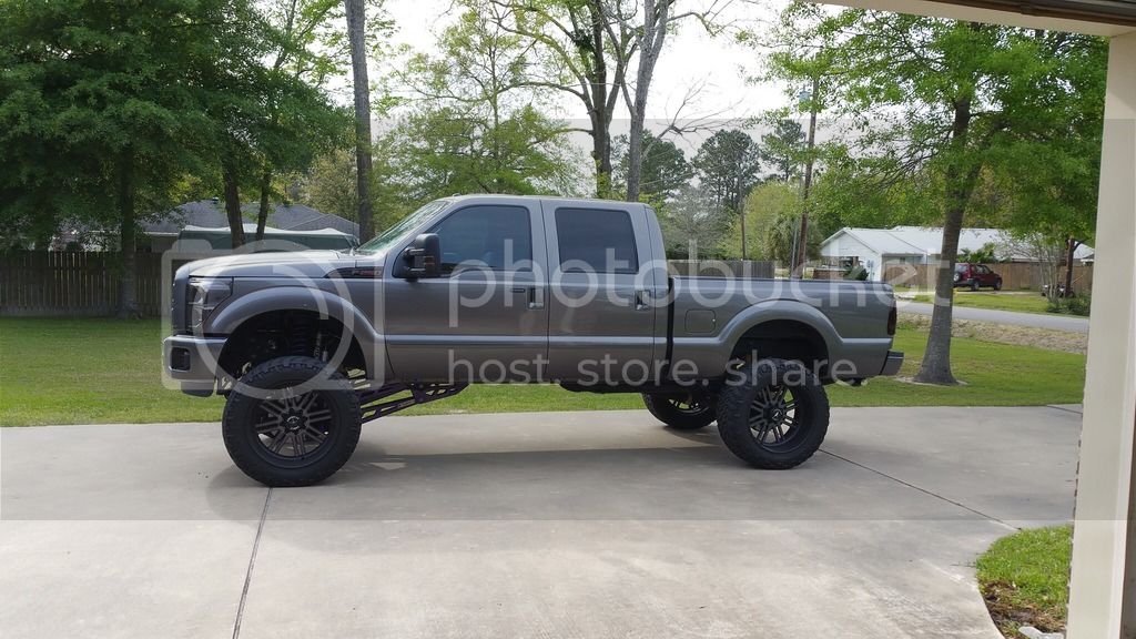

38x13.50 24's 8" lift

Any chance you would have been able to get away with less lift ?
I'm seriously thinking about 38s and 24s on my new truck.

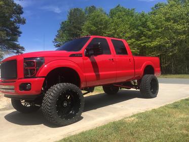

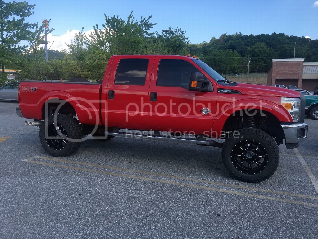

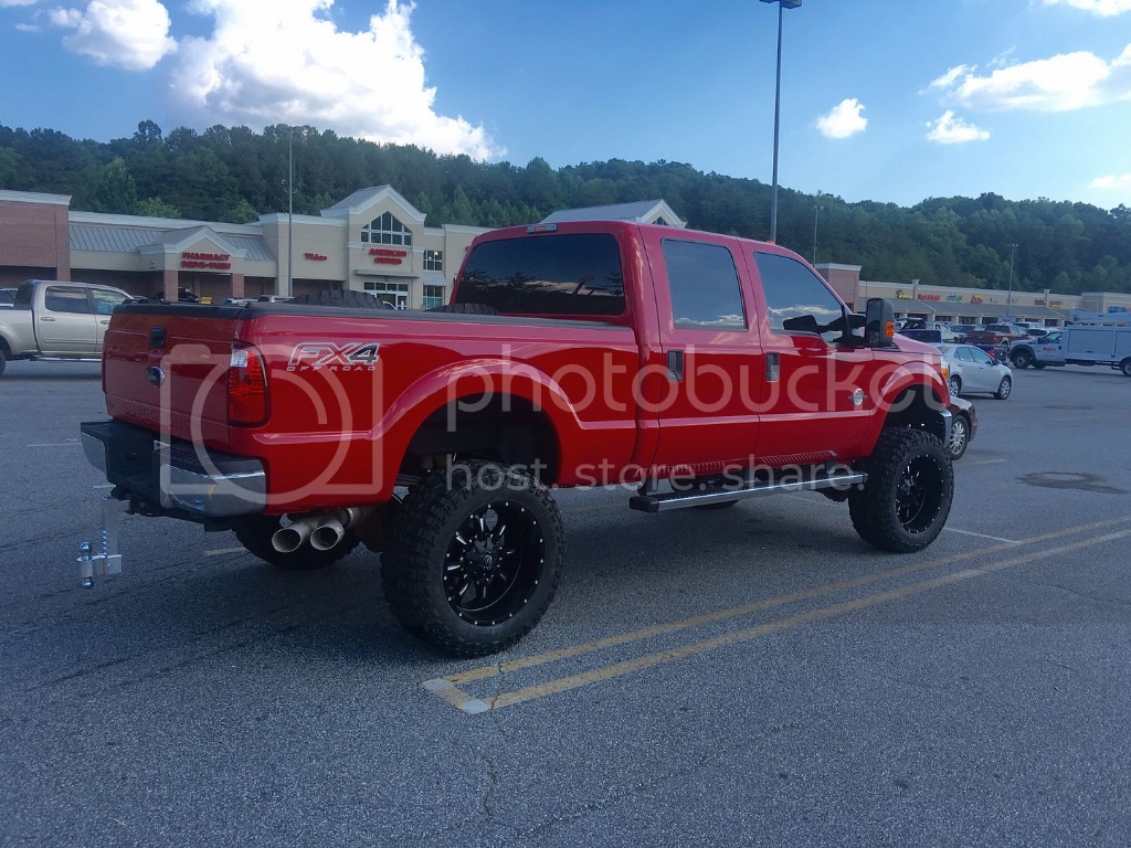

37x13.50x22 with 6in lift. 22x11 wheels -24offset. No scrubbing at all . I would post more pictures but for some reason they won't upload

Lift specs? What else was added with lift? Wheel specs? What tire are you running?
Any more pics?

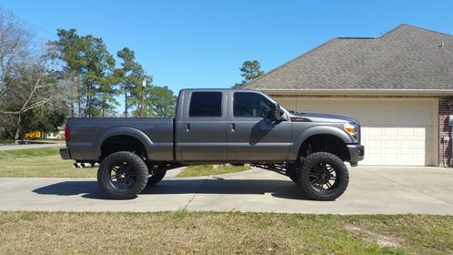

The wheels are 24x12 -40 American forces 38x13.50r24 Nitto Trail Grapplers, lift is 8" Mcgaughy's in the front all powder coated illusion purple with Fox 2.0 reservoirs, Fox dual steering stabilizers, and the rear is Fabtech 6" lifted leafs with stock 2" block all powder coated illusion purple with Fox 2.0's.
I had to do some minor trimming on the inside of the front bumper and had to cut the bottom off of the outer bumper bracket, but it's nothing visible from the outside. I also had to trim the inner fender liner on the passenger side.
With this offset wheel, I don't think it would have been possible to do less lift without significant cutting or an aftermarket bumper to make some room.
I don't really have any more pics as is right now, everything I had was on my phone that died, but here is a few I found.

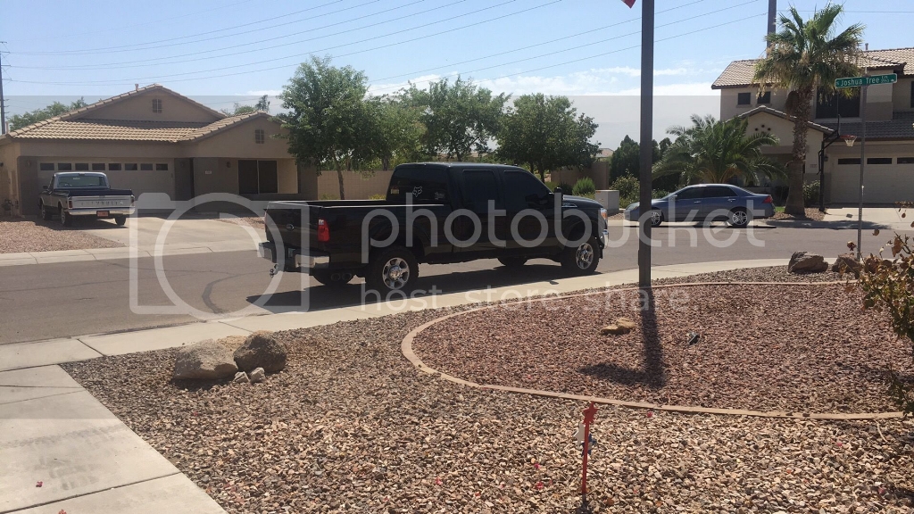

I picked up these 20x10 BMF REPR to go on my black 2015 truck. Was thinking a 7" PMF lift with 37-13.50-20 TOYO MT but I'm thinking about 38-15.50-20 now on an 8" lift....

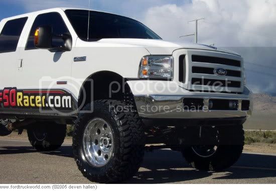

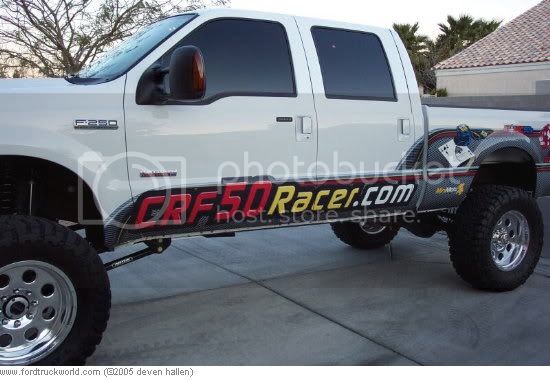

Had an 8" on my 05 with same tire and loved it
The 05- 8" Fabtech lift, 38" Toyos

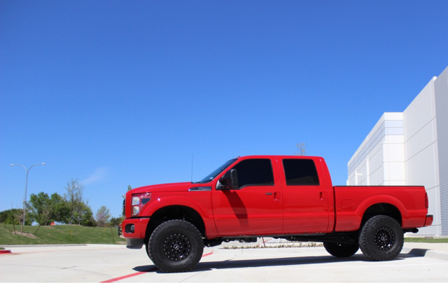

^This. Theres a fella running around on here with a red 6.7 on 37s with just a leveling kit as well. It . Looks bad ass and i hate red. There is pictures of it in th leveled super duty thread in the 6.7 aftermarket section.

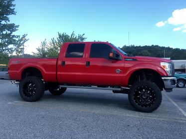

8" lift, 24x14 with 375/40r24 trail grapplers. 2wd front valance trimmed but no rubbing.
