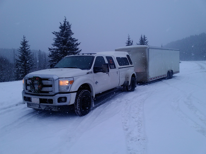

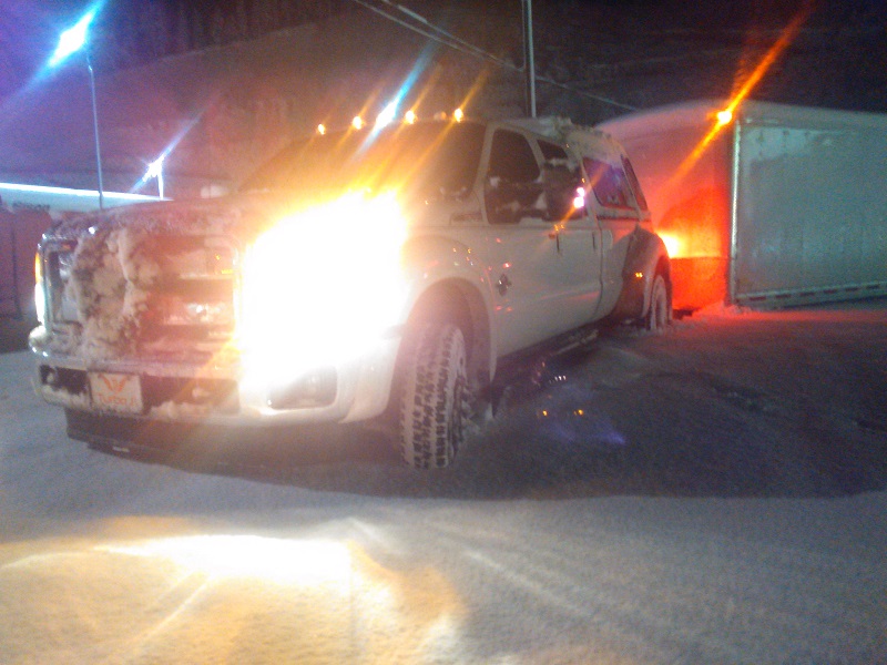

Last year with XDS2 and little trailer, first picture is top of mountain waiting for jackknifed semi to be cleaned up, second picture is 8 hours later at bottom of mountain getting coffee to continue the trip. Not that horrible, much better than the sledbros with M/T's out flipping their trucks over.
