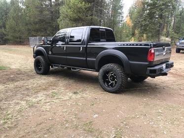

Hey guys just picked up a 2014 platinum Has 194,000 miles but very clean inside and out didn’t make any weird sounds or noises until I had the oil changed and now I have the typewriter tick. Should I run a little heavier oil? What are some good things to do with the higher mileage power strokes? It has the sinister diesel EGR ****** four-inch strait pipe out the back with a tuner. Runs very well shifts smooth. Thanks for any input and advice
